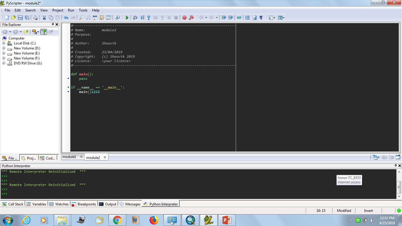

I am getting trouble to run PyScripter version 2.6 on ArcGIS 10.3 and windows 7 64 bit. In PyScripter black screen appearing and could not edit after typing any commend. The backspace is not working at all. several times I unintalled it but the problem is the same. I tried the 3.6 version of PyScripter but its also giving error. Below i have attached the screenshot of my PyScripter on which i am working. How to solve the issue or any alternative of PyScripter for ArcGIS10.3 in windows.

Hi Egge-Jan Pollé Thanks for your response. I solved the issue by installing the version 3.6 32 bit of PyScripter.
