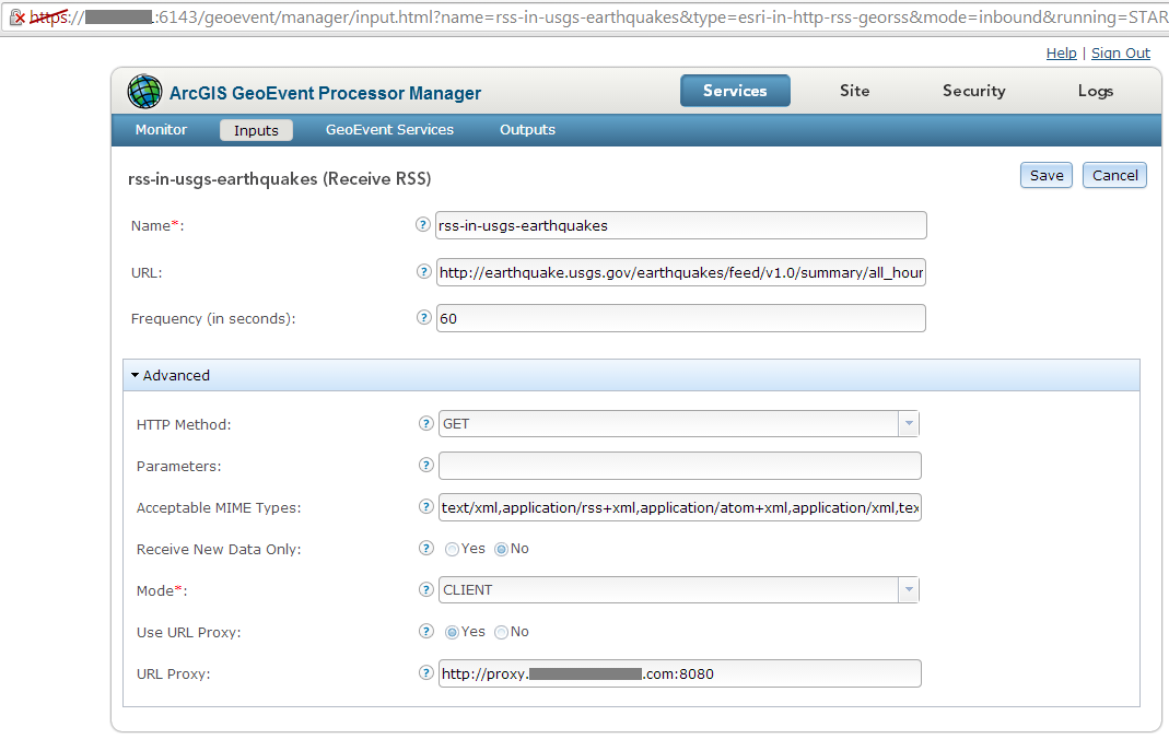

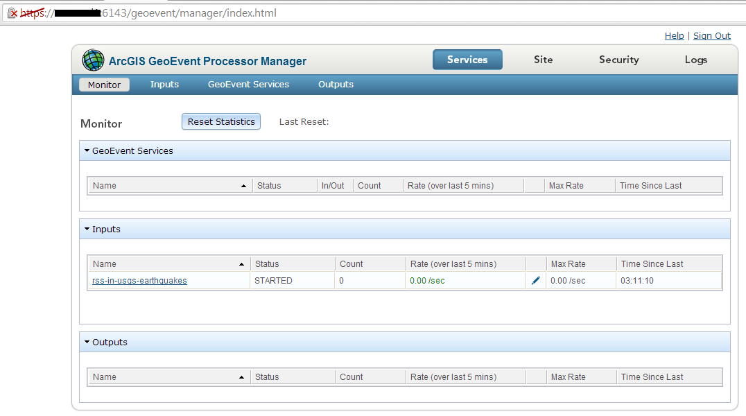

I'm getting an error "Feed Parsing error: can't find the next feed" when testing GeoEvent Processor with an RSS input using the USGS Earthquake URL, below is the full error log. Can someone help?
Restarting Stream 'rss-in-usgs-earthquakes' because the Transport is available again.
Thu Jul 31 16:02:03 CDT 2014
INFO
Stream (rss-in-usgs-earthquakes) has started successfully.
Thu Jul 31 16:06:58 CDT 2014
Camel route collection('rss-in-usgs-earthquakes') is being started...
Route: rss-in-usgs-earthquakes started and consuming from: Endpoint[jms://queue:rss-in-usgs-earthquakes]
SUCCESS!
ERROR
We've figured it out. We had to set the proxy settings in 4 files. 3 of them are called "httpclient" Their locations and format are as follows
\Program Files\ArcGIS\Server\GeoEventProcessor\system\com\esri\ges\framework\httpclient\10.2.2
\Program Files\ArcGIS\Server\GeoEventProcessor\data\cache\bundle6\data\config\com\esri\ges
\Program Files\ArcGIS\Server\GeoEventProcessor\etc
And the fourth file is "net.properties" located \Program Files\ArcGIS\Server\GeoEventProcessor\jre\lib
And the final step was to set the input to not use a URL proxy
