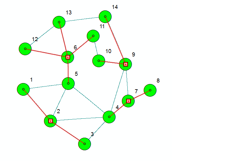

I was reading the Network Analyst Help to see if possible how to assign at least two facilities (Red in the figure; result of analysis) for each demand (Green; data I have) using location allocation tool. I want to find those locations for the facilities so that all demands can reach at least two facilities through only one road. The figure is for the case when one demand can reach at least one facility.The graph is just for example.

Thanks Jay and sorry I was not clear in my last comment.
I've applied your idea (method 2) on a network with 118 nodes and the last graph was a part of it. I followed your two steps. The red circle points are from step 1 and the red square points are from step 2.
Now, there are some facilities (the two red points) I can delete them while still I have for every node of the whole network at least two facilities.
For instance, delete node-39 and you will still have at least 2 facilities connected for each node;
Point 40 has 3 facilities connected to (40, 42 & 37),
Point 37 has 2 facilities (37, 40 & 34)
So, the final solution from the two steps is not a minimum optimal solution for locations of facilities because we can delete some of these facilities and get the objective of the problem.

Thanks Jay; that is a brilliant idea I haven't thought about. But still the result shows some extra facilities since we deal with the problem as two different problems and two separate objective functions. For instance, node-33 and node- 39 in the figure below (I applied your steps of method-2) are not necessary to have them for minimization of facilities. Node-33, with having a facility at its location, still can reach a facility, say node-15, while the other one, node-37, in out of service and vice versa. The same thing is true for node-39. You may ask what about the rest neighbor nodes, for example, node-40, if there is no facility at node-39? still node-40 can reach at least one if the other one is lost.
I've tried your first method as well but for some reason I did not get any reasonable result; I got a facility at each node of my of network.
