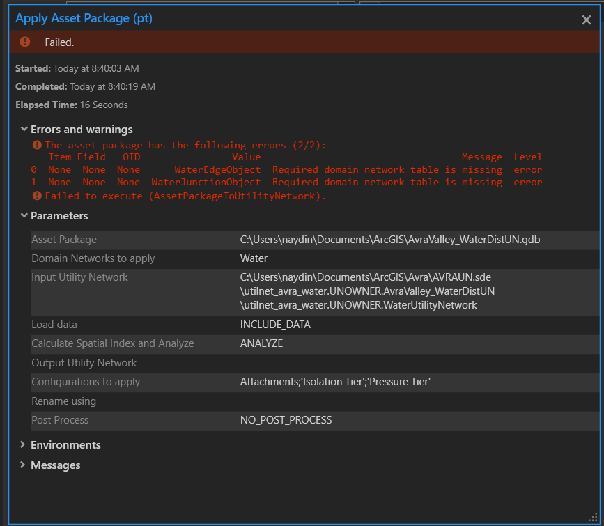

I am in the process of applying the asset package and keep getting the same error:
I talked to esri support and they advised me to try this:
Apply Asset Package: Failed to execute (AssetPackageToUtilityNetwork)
I added a domain network to the sde side but got the same error above
Then I realized I am actually missing the edge and junction tables how do I create them?

To workaround this issue, run upgrade asset package, this will add the missing tables. Did you have the StructureJunctionObject and the StructureEdgeObject classes in the asset package?
It actually worked with a couple of warnings: Some of my features were outside the service territory.
Thank you so much Michael!
We cannot repo the exact error, but have logged a bug we discovered while testing. If you run upgrade asset package and then try your apply, do you have any errors?
I emailed the asset package to you
Nope I do not have those those tables either
Could we get a copy of your Assetpackage? Trying to track down the combo that produces this error.

Expanded error screenshot:

Can you post a view of the rows in the _verison table? Can you also expand your messages in the GP tool to send a pic of that?
