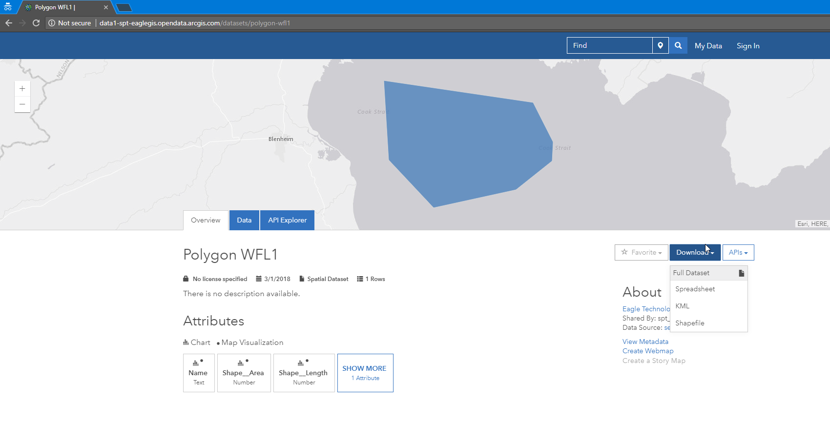

I have a public ArcGIS Hub
ArcGIS Hub
I have a hosted feature service on ArcGIS Online
http://spt-eaglegis.maps.arcgis.com/home/item.html?id=ec7899ee5f5b4c7394753476c08b08d1#overview
And the ability to export is disabled
When I open up in Open Data
The option to download is present. - is this thie right setting to disable downloads?
