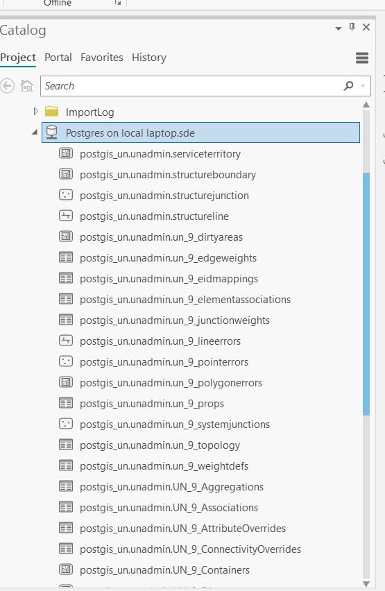

I have tried various methods but only one that is clean is drop the entire database and recreate. It is not possible to do this in a client environment.
Here are the steps I am following in Pro 2.4.3 and ArcGIS 10.7.1;
1. Stop/Drop the UN service.
2. Disable Topology in EGDB using Pro tool
3. Drop the UN topology using Pro. This causes all feature classes to go in a root EGDB.
4. Drop the dataset for UN using Pro. This causes all domains to appear as tables in Pro (even after restart of Pro)
5. Individually drop feature classes and tables and domains.
6. Some domains remain and cannot be dropped.
