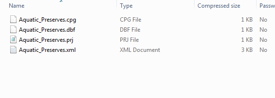

I have noticed this unusual behavior today -some of the data layers on our Open Data site are not being downloaded with all the associated layers. There is no .shp and .shx files present in the zip file for the download. However this happens to only few of the layers. I have reset the download button via the Data Manager site but this has not helped. Any help would be appreciated!

Thanks much for looking into this Daniel! One of the data layers downloaded as expected.
We had already contact support about the download issues last month. We are still not able to download large polygons via the Open Data site. They were not able to offer us a permanent solution after trying different processes. They had logged a bug with the Open Data team regarding this issue.

The first service is failing when trying basic queries, support can help you work through this
http://ca.dep.state.fl.us/arcgis/rest/services/OpenData/AQUATIC_PRESERVES/MapServer/0/query?where=1=1&f=json
The second problem seems to be transient. I reset the download and it is working fine. Please note that the only the refresh button next to each dataset will reset the download. The button at the top of the list will not actually reset the download.
Although I was unable to reproduce your issues in our QA environment, we will continue looking for a permanent solution.
