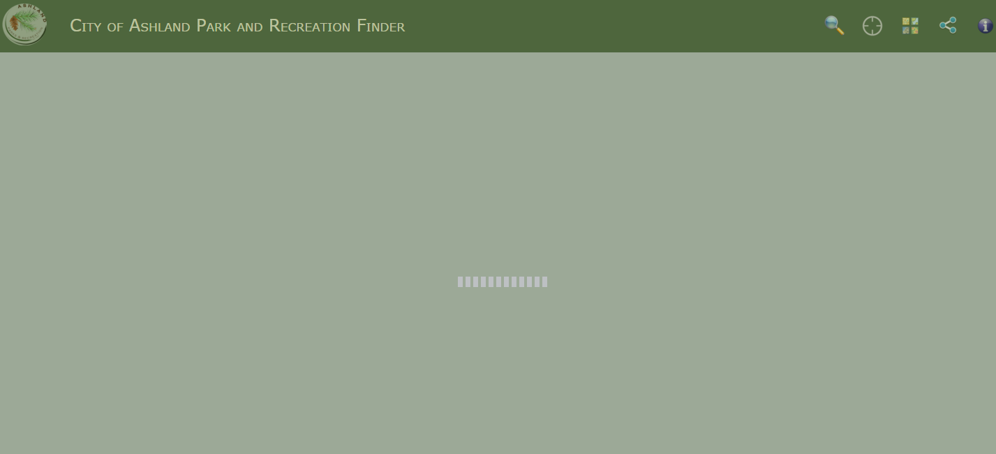

We just switched to Server 10.3 from 10.2, does the app not work with 10.3?
http://gis.ashland.or.us/ashlandparksandrec/
It was working yesterday (we switched last night). I don't see any error and the services seem to be all working.
Any help would be appreciated.
I think the answer is that we did not cache a basemap.
Here is a screenshot in Google Chrome using Developer Tools (F12) set to Console:
There is an Uncaught TypeError: Cannot read property 'getWidth' of undefined
Would this error stop the page from loading? I have not done anything but copy code over, I would not think that would change the app unless it is a 10.3 thing.
I don't know if this error would stop the page from loading, as I was just reporting the error from Developer Tools.
Can you test reverting back to 10.2 AGS services?
Yes we got the 10.2 up and running. It now works because we are pointing to the old server. This makes me think that it is something we missed or that it is not compatible with 10.3.
