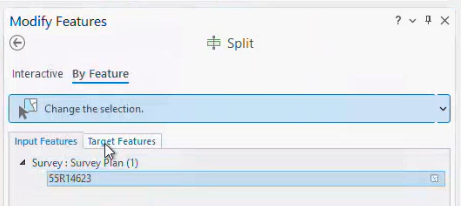

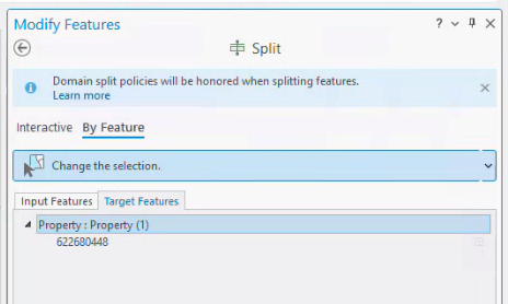

- Use the Split Parcel tool to split the parcel
- In the tool: select the existing survey line in the middle of the parcel to split it

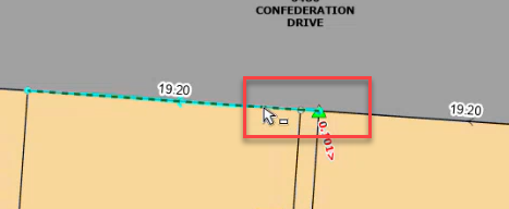

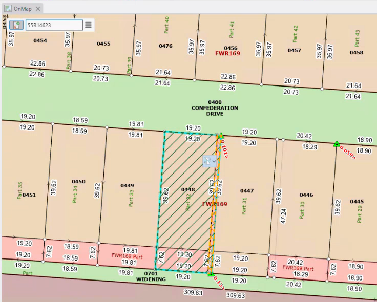

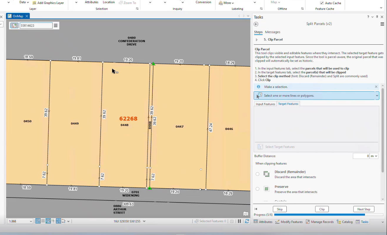

Result: Using the current Split tool, it does not split the associated parcel lines. Only the parcel geometry is changed. This results in the use of the Clip tool instead to “Split” parcels
While the current Split tool successfully creates the new parcel geometry, it does not fully update the underlying parcel line structure.
Current behavior:
- The parcel is split as expected

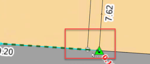

- Existing parcel lines remain unchanged
- Lines are not split at the location where the parcel is divided
- The tool is not fully parcel aware with respect to maintaining parcel lines
In the example shown below, an existing survey line was used to split a parent parcel. While the resulting parcel polygons were created correctly, the associated parcel linework was not automatically segmented at the new parcel corners and intersections created by the split. This resulted in parcel geometry and parcel linework becoming out of sync and required additional manual editing to restore parcel fabric integrity.
