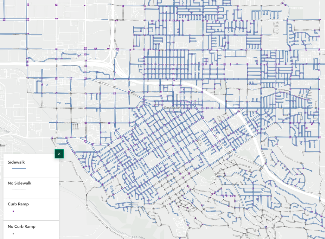

I knew I was interested in studying sidewalks. After tripping over a displaced sidewalk panel for the umpteenth time while out running, I wondered, “Can’t GIS be used to make Redlands safer for us pedestrians out here?” As it turns out, Esri had just launched version 1.0 of Sidewalk Management, an ArcGIS Solution for organizations to, well, manage sidewalks. It includes a preconfigured geodatabase and a suite of ArcGIS apps that allow state and local governments to generate a sidewalk inventory, assess sidewalk conditions, and visualize compliance with ADA regulations. Basically, it provides the GIS tools needed for sidewalk management, just not the manpower to use them.
A map showing the sidewalk infrastructure network in Redlands, CA, including the locations of street sides without sidewalks and street intersections without curb ramps.

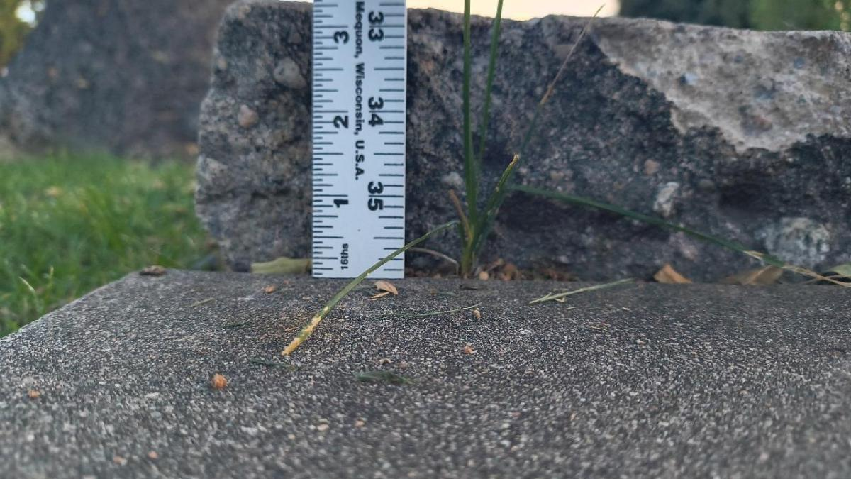

As I alluded to before, the main problem with sidewalk conditions in Redlands is the prevalence of vertical faults that create tripping hazards. I walked around a few neighborhoods with a yardstick to measure the heights of these faults and a smartphone to record their locations and measurements using the solution’s ArcGIS QuickCapture app. It was exciting to get hands-on experience with using GIS to collect data in the field. I later used the solution's ArcGIS Fields Maps app to update the data, as I discovered that some of the vertical faults had been fixed!
A vertical fault and a yardstick showing that its height exceeds 3 inches. A major tripping hazard and a serious violation of the Americans with Disabilities Act.

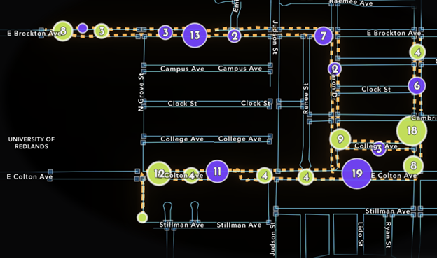

It was also extremely rewarding later to see that data visualized in the solution’s web maps created in Map Viewer and experiences built in ArcGIS Experience Builder. I took the liberty of changing the basemap to a dark theme, creating a stark backdrop for my brighter symbology colors. Check out my StoryMap (using ArcGIS StoryMaps), which provides an interactive map-based exploration of the data.
A map showing clusters of vertical faults in sidewalks in Redlands, classed according to whether the predominant apparent cause is tree roots (green) or unknown (purple).
