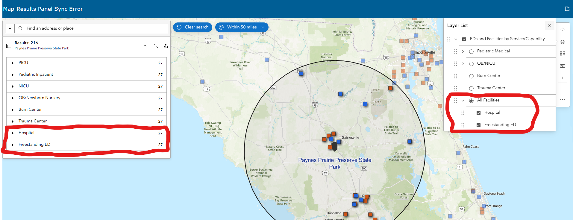

I have an app created using the Nearby template. The map and layer list use exclusive visibility, or radio-button behavior, so that only one or two layers are displayed at a time.
Before the recent UI and feature updates, the results panel displayed results only from layers that were currently visible in the map/toggled on in the layer list, which is the desired behavior. After the updates, the results panel displays results from all layers, regardless of whether those layers are currently visible.
As shown in the screenshot attached, only the "Hospital" and "Freestanding ED" layers should be appearing the results panel (highlighted in red) corresponding to the layer list selection and map visibility, instead, all layers are appearing the results panel.
The results panel also appears to ignore the attribute filter applied to each layer (Note: Each layer shares the same data source). For every layer, the panel reports the total number of features from the underlying data source that fall within the search radius rather than the number of features matching that layer’s filter. In the screenshot example, "Hospital" reports 27 records in the search radius - this is not correct and includes results that do not belong to that filtered category.
I have confirmed that the "panel syncs with map" setting is selected. Is there another setting that I am missing?
