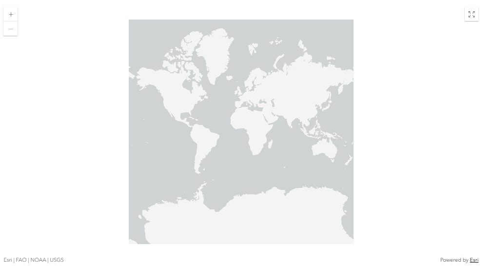

Before adding any layers, let’s just display the blank map. It should show a light grey basemap of the world fully zoomed out.
# Display the blank map
map.display()

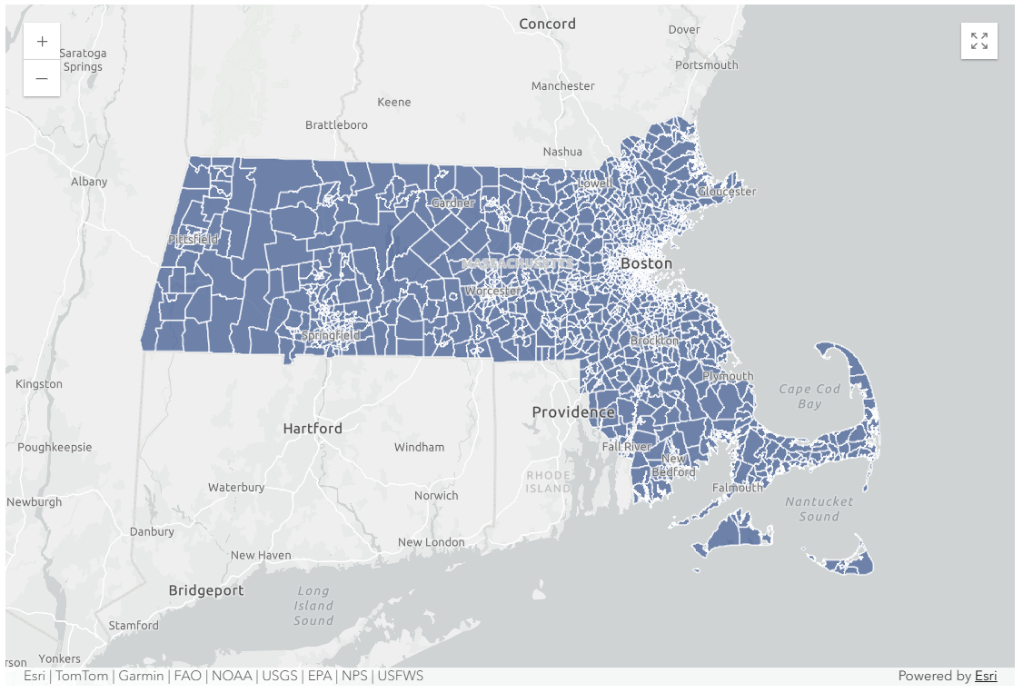

In this example, you can add the DataFrame of all the census tracts of Massachusetts to the EsriJSMap. The display function outputs the interactive map, showing the basic geometry at multiple zoom levels. The EsriJSMap object keeps track of the layers being added, so creating a display with different layers may require redefining the map class before adding new layers. If the same DataFrame is added to the map and the map is displayed before the map is redefined, the layer will be rendered twice unnecessarily. For future examples, this is avoided using the jsmapping script's display_layer and display_raster_layer functions.
# Add and display the DataFrame
map = geoanalytics_engine_jsmapping.EsriJSMap()
map.add_layer(df)
map.display()

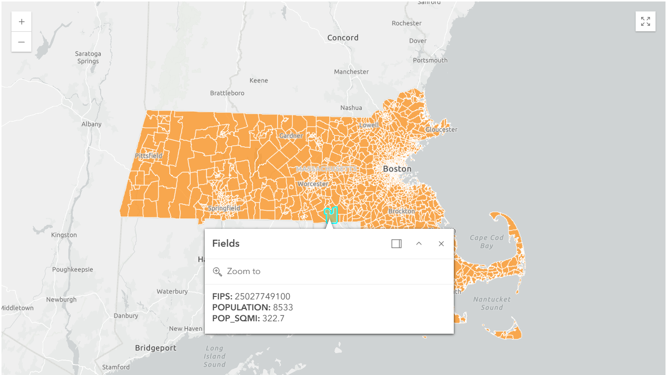

Add Pop-Ups to data layers
Pop-ups can be added to vector layers as a parameter in the add_layer or display_layer functions. You can provide an array of field names that can appear for each geometry when it is selected. The title of the pop-ups will always be “Fields” unless explicitly stated using a PopupProperties constructor JSON object. In this example, the FIPS code, population, and population per square mile are added as pop-up fields.
For more information about customizing pop-up displays with constructor JSON objects, see the Maps SDK for JavaScript Popup documentation.
# Display the DataFrame with a Pop-Up
map.display_layer(df, popup = ['FIPS', 'POPULATION', 'POP_SQMI'])

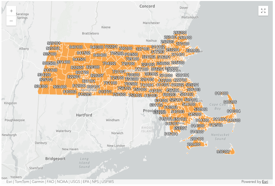

Add Labels to data layers
Labels can be defined as the string of a field name or a constructor JSON object of label properties to display over each geometry. Using the label parameter, you can give a quick overview of a field, such as the tract FIPS code.
For more information about customizing labels with constructor JSON objects, visit the Maps SDK for JavaScript Labels documentation.
# Display the DataFrame with a Label
map.display_layer(df, label = "TRACT_FIPS")

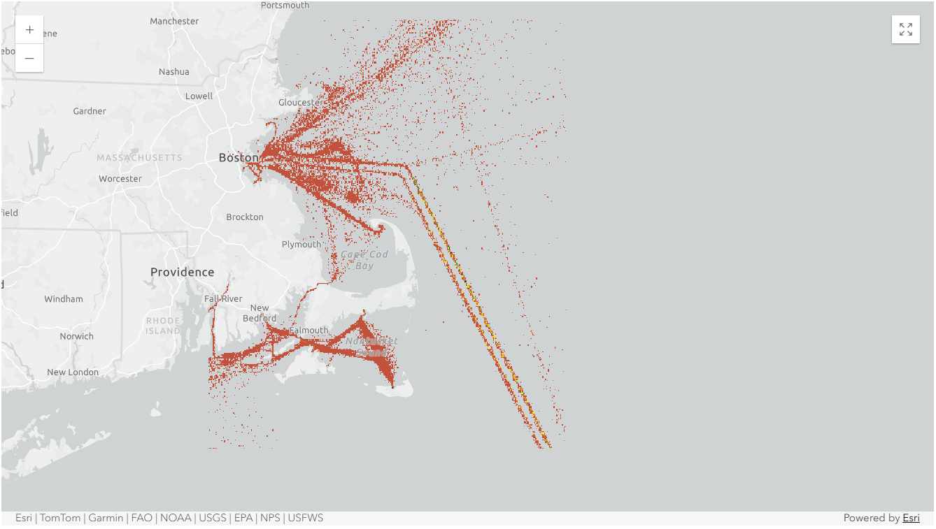

In addition to adding vector DataFrames, raster DataFrames can also be added to the EsriJSMap. Here, I have used a sample Image Service of AIS passenger vessel positions loaded in as an example raster DataFrame. You can also define your own Colormap or choose from a limited set of pre-made colormaps to display raster data. In this example, the "Precipitation" colormap was used to display the density of passenger vessels from January 2015 to February 2021, where colors of red, yellow, green, and blue represent density from low to high in that order. Please note that Colormaps can only be used as a parameter of the add_raster_layer function.
# Path to the AIS positions reported by passenger vessels
raster_path = "https://tiledimageservices.arcgis.com/P3ePLMYs2RVChkJx/arcgis/rest/services/Global_Ship_Density_Passenger/ImageServer"
# Passenger vessels around the coast of Massachusetts
raster = spark.read.format("image-service").option("extent", "-71.25, 41, -69, 43").load(raster_path)
# Display the raster DataFrame
map.add_raster_layer(raster, colormap = "Precipitation")
map.display()

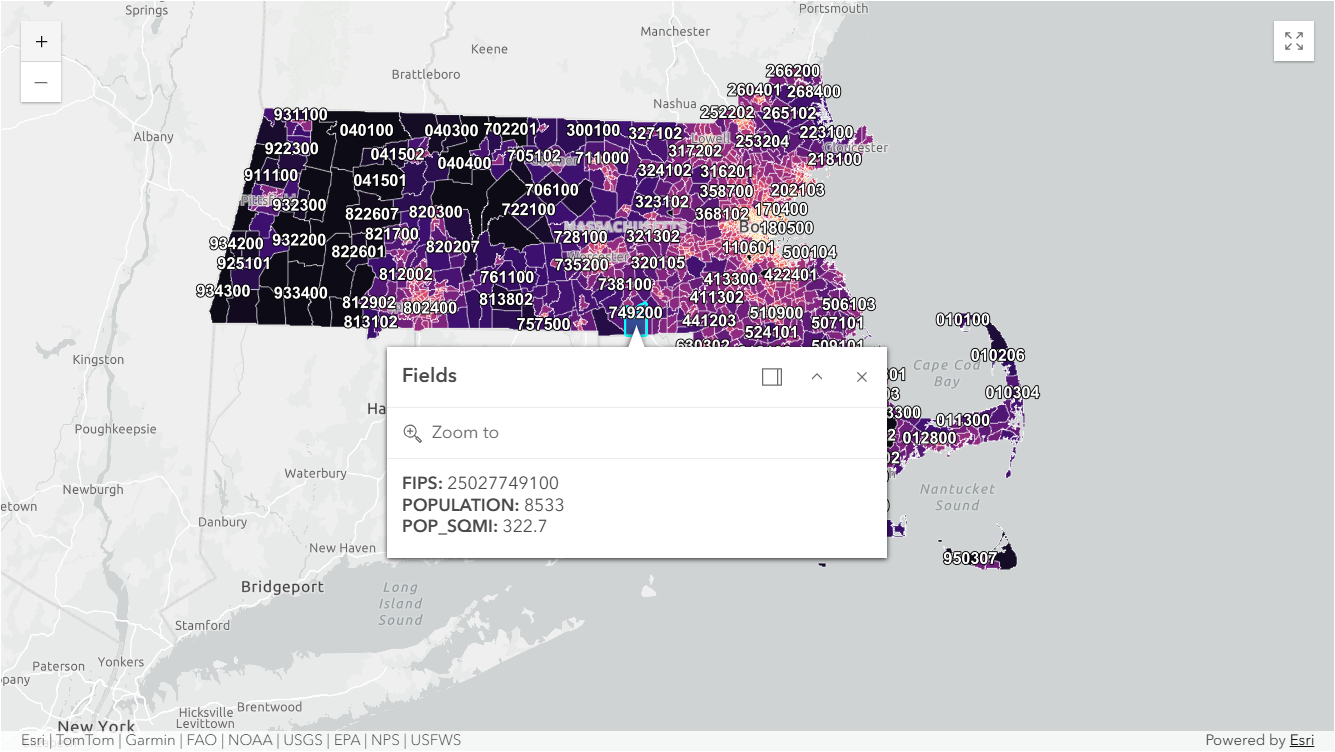

Create interactive maps with Visual Variables
With Pop-Ups, Labels, and Renderers together, you can create a final interactive map. Using Visual Variables, field values can change the appearance of vector layers. Visual Variables are represented as an item in a renderer JSON object, describing visual changes and the fields that affect them. For this example, a Colormap is used to represent population density. Keep in mind that colormaps that have non-linear or non-categorical styles must be explicitly defined as I have done here. This example combines Popups, Labels, and Renderers to create an interactive map describing the population spread of census tracts in the state of Massachusetts.
# Display the DataFrame using Visual Variables
label = "TRACT_FIPS",
popup = ['FIPS', 'POPULATION', 'POP_SQMI'],
renderer = {
"type": "simple",
"symbol": {
"type": "simple-fill",
"color": [150, 150, 150, 0],
"outline": {
"color": [255, 255, 255, 0.5],
"width": 0.5,
"visualVariables": [
"type": "color",
"field": "POP_SQMI",
"stops": [
{ "value": 50, "color": "#0d0b16" },
{ "value": 200, "color": "#3b0f6f" },
{ "value": 1000, "color": "#8c2981" },
{ "value": 5000, "color": "#de4968" },
{ "value": 20000, "color": "#fca636" },
{ "value": 100000, "color": "#fbf47a" }
