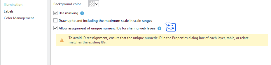

It looks like the what is in your screenshot is what I had in mind and I would rather have the undo/redo than a confirmation box now that you mention it.

This reset option was introduced in ArcGIS Pro 3.6. Can you pls try and let us know? Please note that this action is undo/redo-able, so that if you make some changes by accident, you can roll it back
