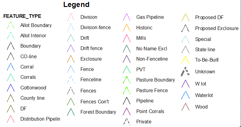

Here It is a boring legend of the feature type I have for a Rangeland Improvement line layer . It is a range line by type that I need to sort out different shapes of patch lines . Is there a way around to make them more interesting patches to break them down ?
40 classes? Are there any more than abou 7-10 at anyone time? I suspect that the map will become a blur beyond that . I don't suppose it is in the cards to produce targeted maps by theme to widdle down the classes, fix that symbology up which could be repurposed in another with a different theme
Good question, Dan. This legend is meant for the specialists that are going through to do some cleaning up like some of the words do not make sense. So, I was trying to make them each of them breakdown, but I did not realized that 40 is too much ...You are right that they should be smaller classes about 10 of them.
