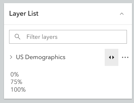

I am trying to embed an opacity slider in the LayerList Component inside of the listItemCreatedFunction. I get an opacity slider, but CSS formatting from themes never seem to make it to the ESRi based Slider.

Hi @JamesVillanueva2 ,
It's likely because of the ShadowDOM preventing from setting the styles of the widget. I'd suggest sticking to the calcite-slider approach current sample app shows for now. If you just want to change the look to be similar to the old dark theme you can set the "calcite-mode-dark" class on the body or on the map as this example shows.https://codepen.io/sagewall/pen/QwErBGL
In general I'd try to avoid mixing old widgets and the new components if at all possible.
In the next 5.0 release we will have a new slider components including an opacity slider component.
