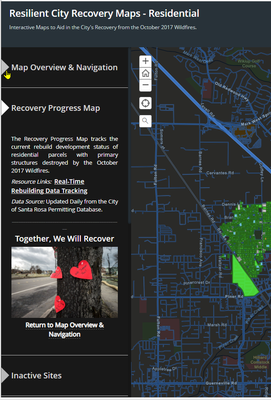

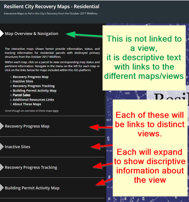

My existing Classic Map Series has a left side pane for navigating between the different maps (see screen captures below). In addition to navigation, the left side pane also provides descriptive context for each of the maps. I do not know how to recreate the same user experience in a new web app, specifically I'm hoping for help recreating the 4 functions listed below.
Below are the functions that I need to replicate from the existing map series app over to the new web app:
- User navigates between different maps via selecting items from a fixed pane on the left side.
- clicking a map in the navigation jumps to the map
- clicking a map in the navigation expands to provide a description & branding image.
- some of the items in the navigation pane are not linked to a map, instead they expand to provide descriptive text (e.g. items: Map Overview & Navigation, Additional Resource Links, About These Maps)
