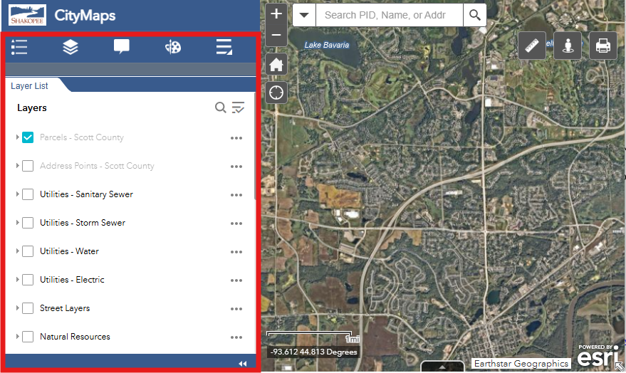

The transition from Web AppBuilder to Experience Builder has limited our ability to stack map widgets and have the widget open in a tab of the screen. Below is what we currently have in Web AppBuilder and are looking to replicate in Experience Builder but am currently unable to:
Thank you,
Ryan

You'll want to use the Section and View Navigator widgets and it will look something like this:
If you look at the Tab template under Web App Builder Classic, it uses this, just the tabs are vertical along the left side.
