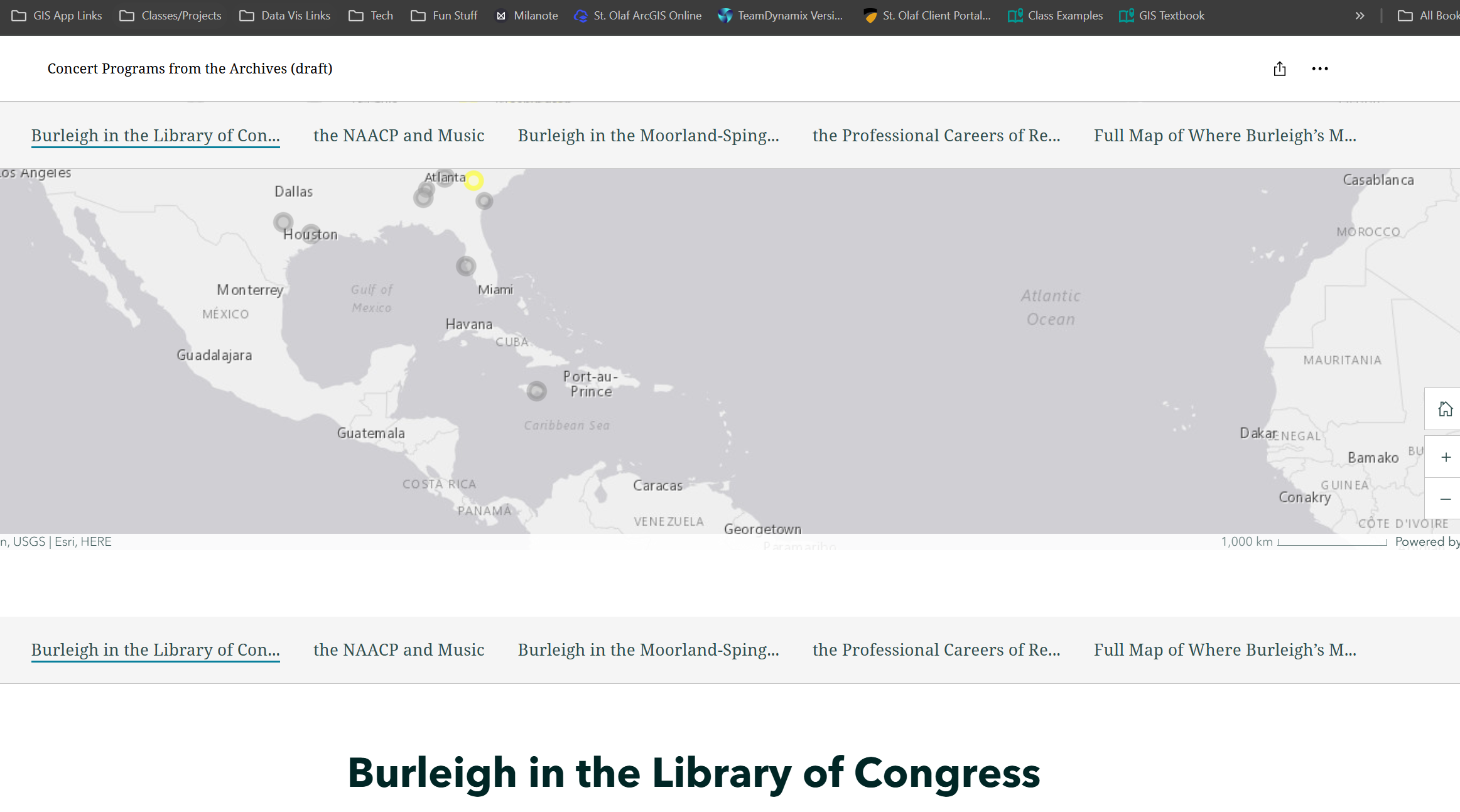

I have no idea how this happened - but somehow I ended up with duplicate navigation bars and I can't figure out how to get rid of the extra one. I've tried clearing the cache, multiple browsers, opening it in an incognito window....everything I could think of.

Hey @SaraJL , after looking into the story, there is another navigation in the story structure (which should not happen). I also noticed the story was edited with python. Was this story created with a specific python script?
@ThePreatorian I created this one with the StoryMap converter tool! This is actually one I was trying to convert from the Cascade legacy template.
I converted it first - but for some reason, the tool only pulled over the top section of the StoryMap, so I had to manually recreate the rest of it. I turned on the Navigation at the very end, and that's when the duplicate bar showed up. It didn't do that with the others I was working on, so I couldn't figure out what the cause might be.
