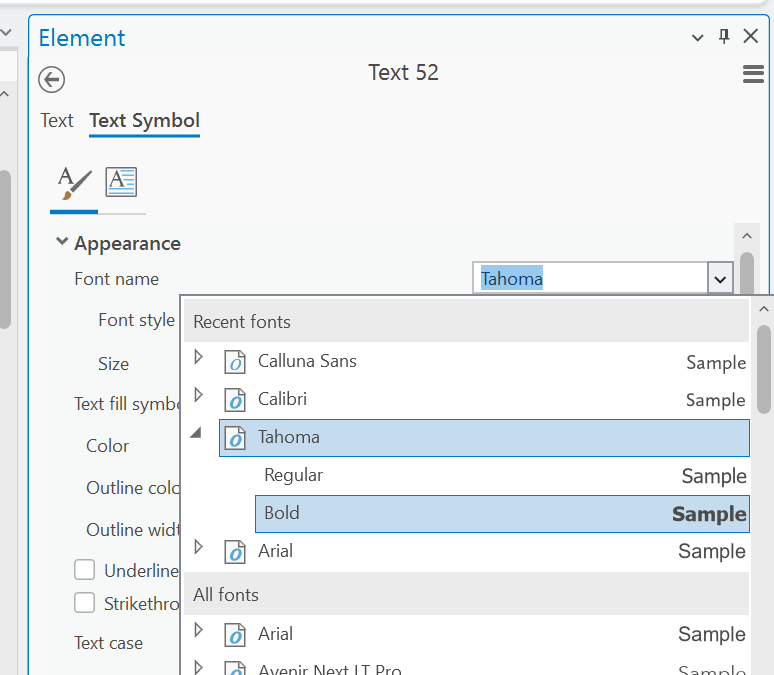

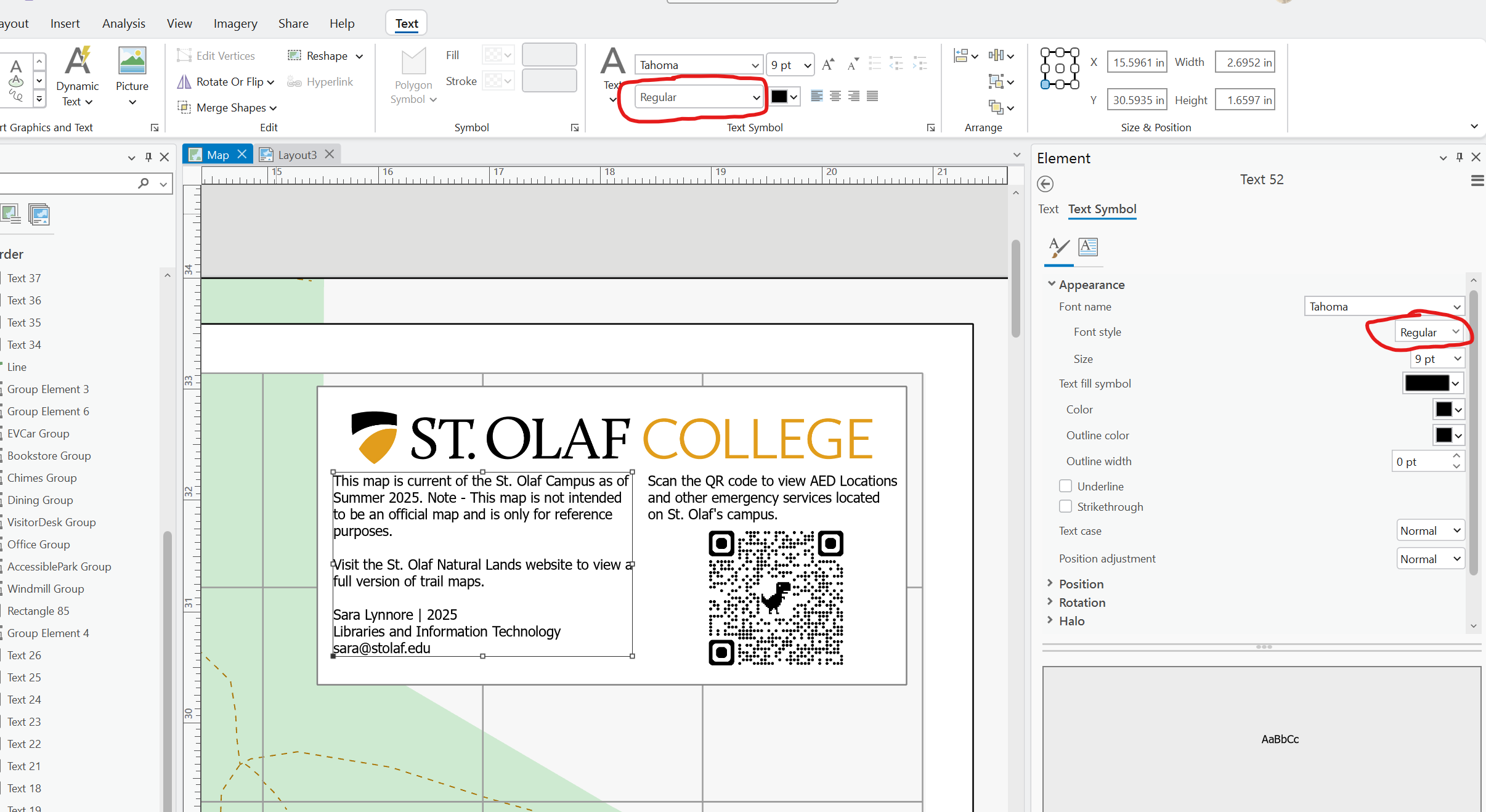

I would like italics to be added as an option for the ArcGIS Pro Layout fonts.
Or at least - change the default text from Tahoma.....It looks like the only way to really add italics to this text in the layout view that I've seen is adding html tags or attempting to add a custom font package to ArcGIS Pro.

HiTahoma does not have an Italic style. You are correct that you would need to use another font.Once you've decided on a font you can make it the default for ArcGIS Pro. See this help topic.
