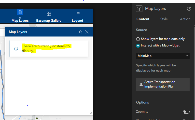

I have duplicated an Experience that one of my colleagues created and would like to use it like a template and repurpose it for another project. I have swapped out the map for the one that I need. The experience contains Map Layers and Legend widgets. Both are connected to my new map but I get a notification that says "there are currently no items to display." in both of the widgets. How do I get the widgets to display the layers in my new map?

Thanks for the suggestions. All of the layers are checked on in the Map Layers widget. When I switch them on and off the widget flickers slightly and then continues to display the no items to display message.
I don't believe the map is in another layout panel etc. My experience only contains one Page, so that isn't the issue either. It's strange that the layers appear when I select the show layers for map data only and then disappear when I choose Interact with a Map widget.

Ok. Did you go into the Map Layers widget and select any layers? When none are selected you'll also get that message.
No items selected:
Items selected (blue check marks next to layers):
Yes, you can see in my screen capture that I chose MainMap from the dropdown and the Active Transportation Implementation Plan map is listed below that. When I click show layers from map only the layers are visible. I want the user to be able to switch the layers on and off though so I turned on Interact with a Map widget.
Back in the Map widget are you sure it is selected? That happens when no map is selected, for ex:
