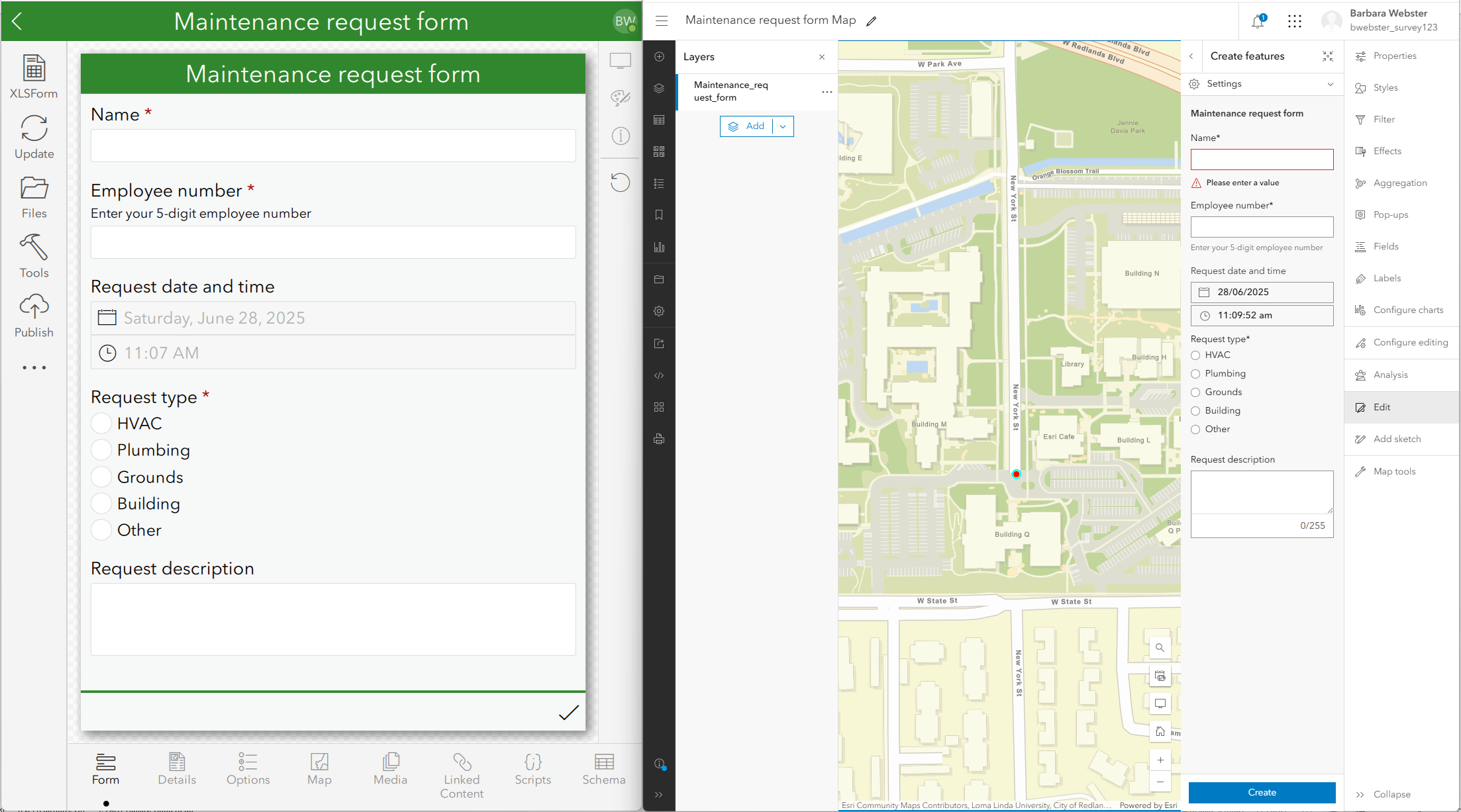

Many workflows require viewing or editing data at multiple points in the workflow, from collecting data, reviewing data, and sharing with stakeholders. Often the requirements of each step in the workflow are best met by different ArcGIS apps. For example, a team may prefer to collect field data using the Survey123 field app and then review that data in a web app or dashboard in the office.
Even though the various steps in a workflow can be different enough to require different apps, there are still many consistencies in the way data is presented throughout the entire workflow. For example, if a description of a maintenance request is expected to be a larger amount of text, both the request submitter and reviewer will likely want this information to be displayed as a text box with multiple lines.

Map with forms – Web maps support configuring forms that are stored in the web map and that allow editors to view or edit fields within the feature layers or tables. These web map forms can be used by a few different ArcGIS apps, including ArcGIS Map Viewer, ArcGIS Field Maps, and ArcGIS Web Editor.

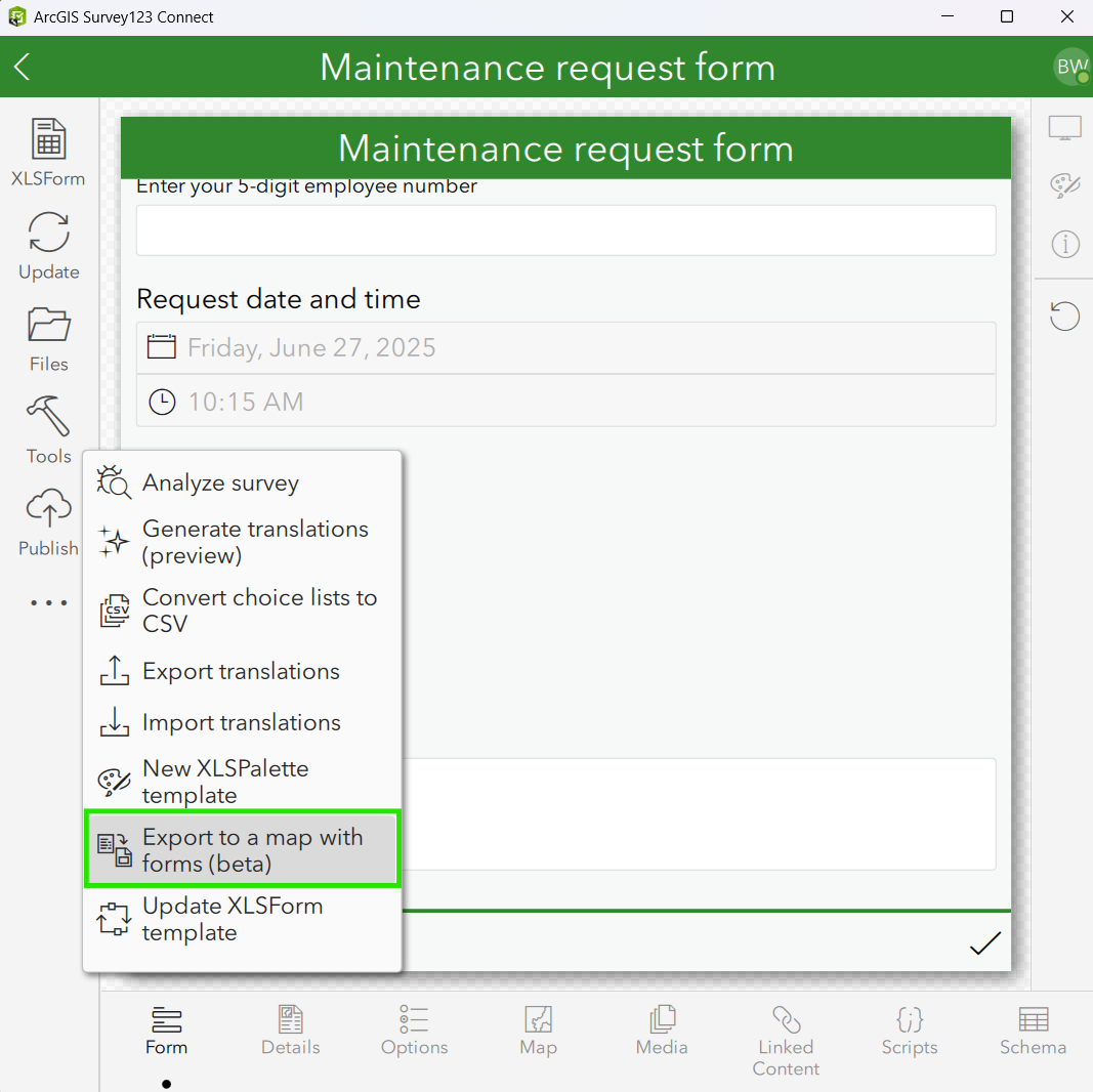

The tool is located in Tools menu of Survey 123 Connect.

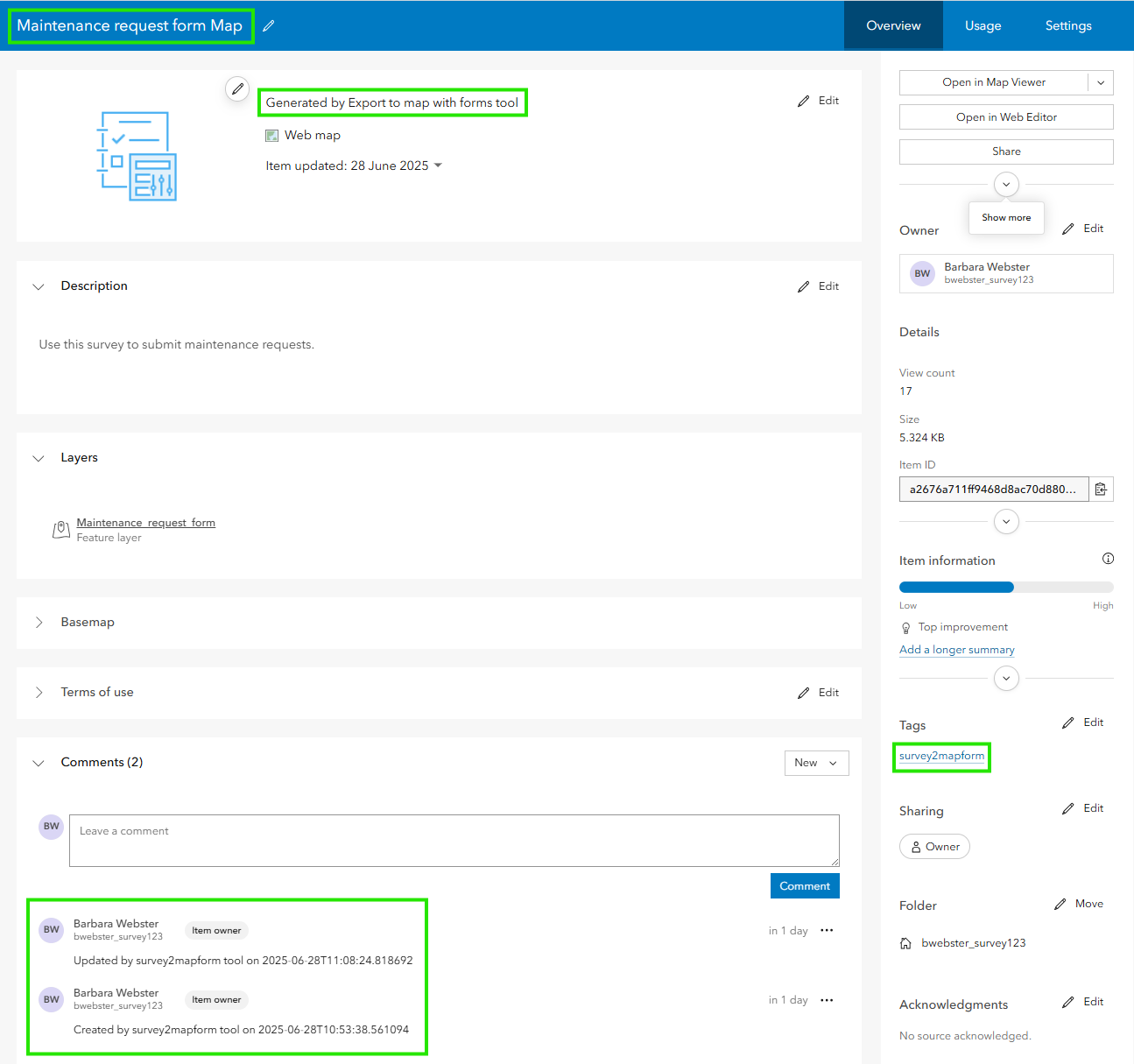

When the tool is run for the first time, it creates a new web map with the same name as your survey item and “Map” appended to the end. The new web map includes a tag (survey2mapform), summary, and comment that indicate that the web map was generated by the tool. The tool adds the feature layer or feature layer view to the map, as well as any related layers or tables. It then creates one or more forms in the web map. Multiple forms are created if the survey contains repeats, and the form is saved in the web map (not the feature layer). The saved form contains elements that are equivalent to the questions in the survey.
When a survey author runs the tool again, the generated map is updated with any applicable survey edits. The tool checks the survey's related web maps for the unique tag (survey2mapform) to determine if there is a corresponding map to update; otherwise, it creates a new map.
