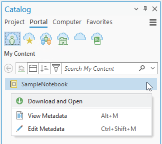

- Using Notebooks hosted on Enterprise Portal in ArcGIS Pro: There are several options for moving a hosted notebook to your local machine.
- igned into a portal within ArcGIS Pro. From the Catalog pane in ArcGIS Pro, go to Portal > My Content, right-click a notebook item, and select Download and Open.
