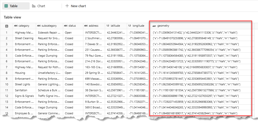

# create a new column called geometry for each record
# when we create the point geometries here, we are adding an optional value for the spatial reference. In this case it is 4326 (the World Geodetic Survey of 1984, or WGS84)
df = df\
.withColumn("geometry", ST.point("Longitude", "Latitude", 4326))
When displaying tables with a geometry, the point, line, or polygon geometry is automatically converted into a more human-readable format for display.
Take a look at the point geometry as listed in new geometry column - we have a single column with all of the details for our points. We can now use this for analysis or visualization using GeoAnalytics for Fabric.

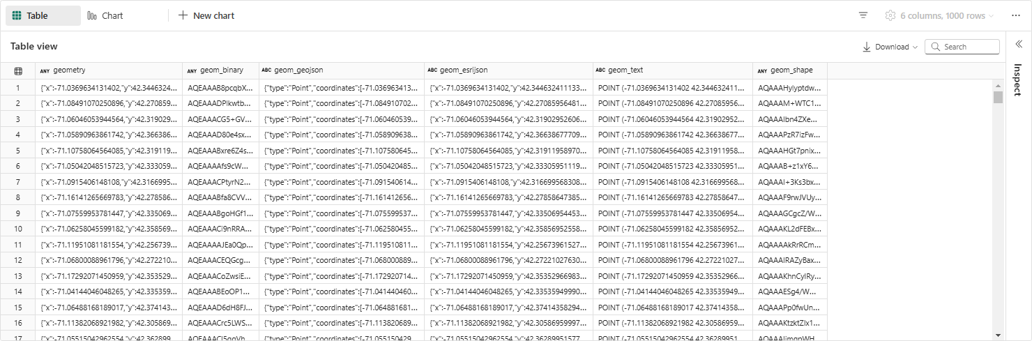

# show the results of converting a geometry to binary, geoJSON, esriJSON, text, and shape formats
display(
df.select("geometry",
ST.as_binary("geometry").alias("geom_binary"),
ST.as_geojson("geometry").alias("geom_geojson"),
ST.as_esri_json("geometry").alias("geom_esrijson"),
ST.as_text("geometry").alias("geom_text"),
ST.as_shape("geometry").alias("geom_shape"))
The GeoJSON, EsriJSON, and well-known text (WKT) formats are all human-readable representations of the geometry.
The well-known binary and shapefile representations are not.
We can see all of these in the image of the displayed table below:
