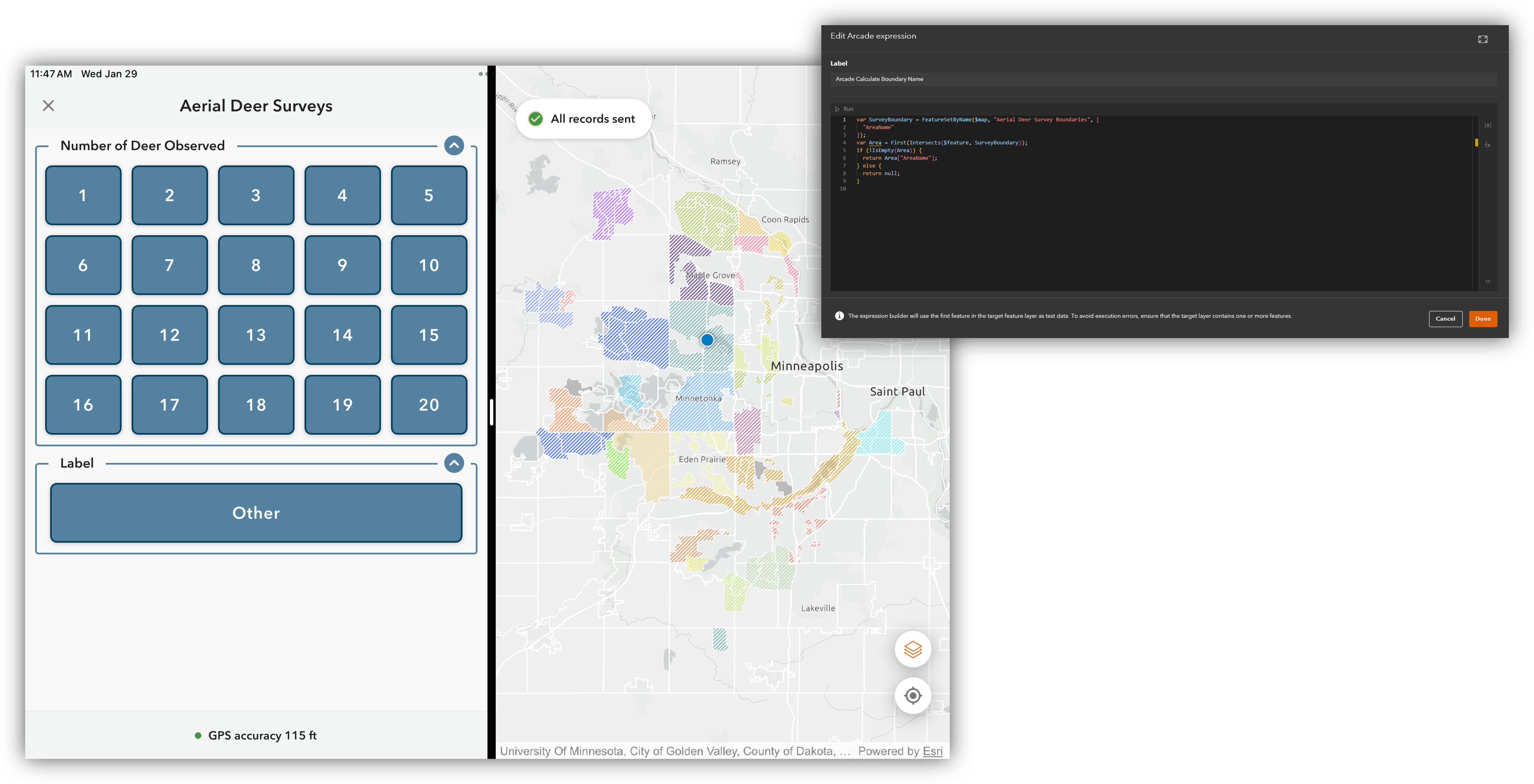

Using QuickCapture wildlife staff are able to collect data with speed through a ‘big button’ interface. When a button is selected a point on the map is created and updates underlying ArcGIS Online Hosted Feature Layer with the ‘Deer Count’ attribute. In addition, Arcade FeatureSets are used to capture the information from the boundary area they're flying over and automatically add those attributes to the point as well.

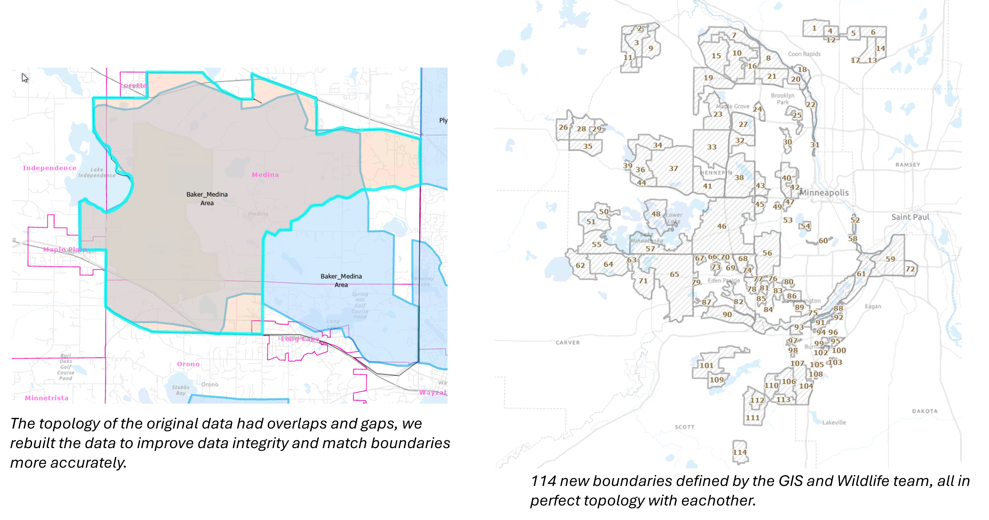

To ensure the accuracy of boundary information that automatically being captured, the GIS and Wildlife teams needed to address the topology of the Survey Boundary data. The prior boundary dataset was in dire need for cleanup, the data been passed along through many generations of wildlife employees and data quality was not taken into account. Using ArcGIS Pro, both teams determined that hand digitizing was needed and redefined these 114 boundaries to ensure the data being collected was correct.

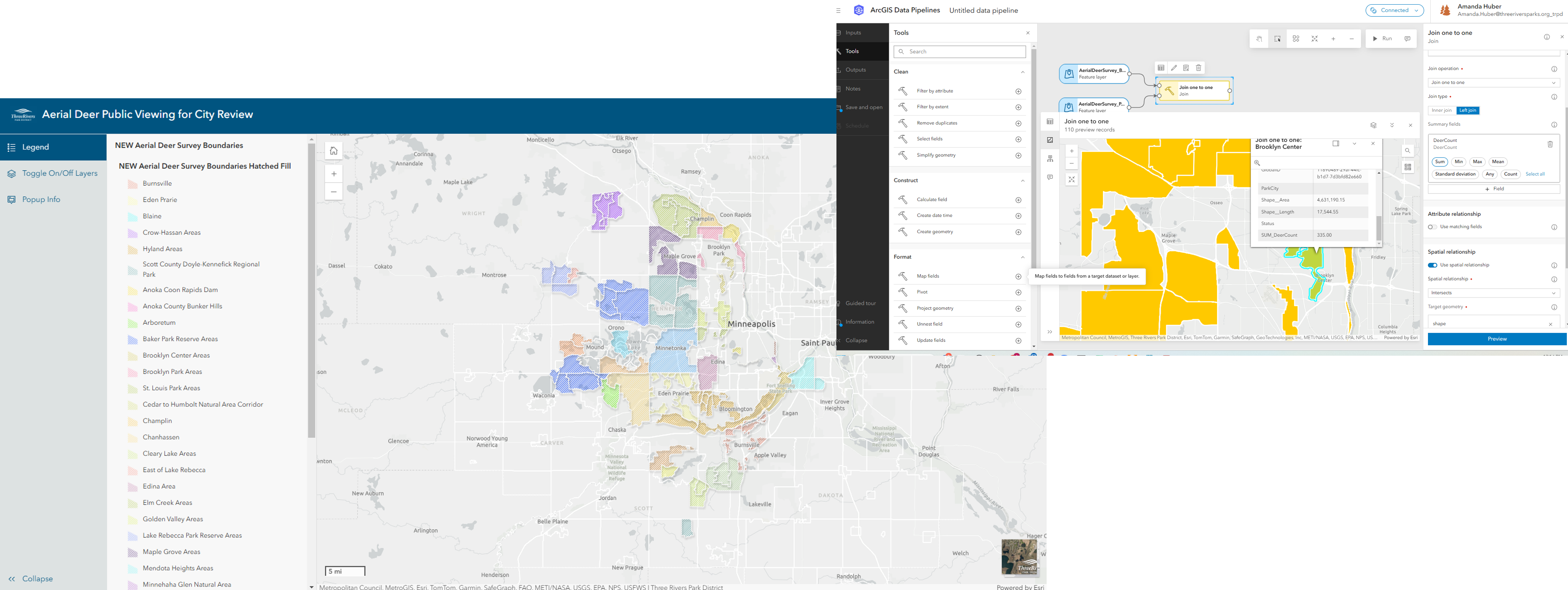

To visualize final counts, the GIS team is constructing a dashboard for wildlife administrators to view a report of captured counts. Using a series of AGOL Hosted Views and ArcGIS Data Pipelines we ‘ve created a scheduled task that will query the current year’s aerial count locations and joined them to their respective polygon areas. This automation allows us to display and report statistics within the dashboard. We’re still in the process of constructing this but we will update the post once this final portion of the project is complete.
