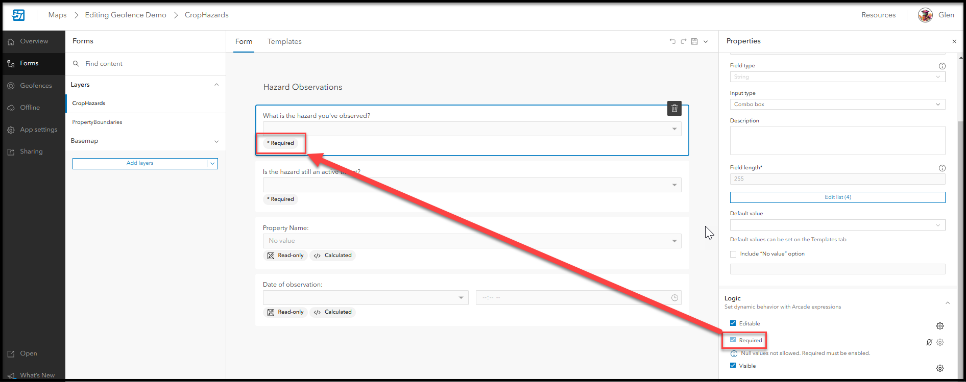

When configuring the form for the edit-enabled layer, set a field to be *Required:
Then, for the same field, click on the settings cog next to the 'Editable' logic to configure an Arcade expression:
Name your expression something like 'Editable Geofence', then click on 'Launch Arcade editor', and use the following Arcade example as a guide:

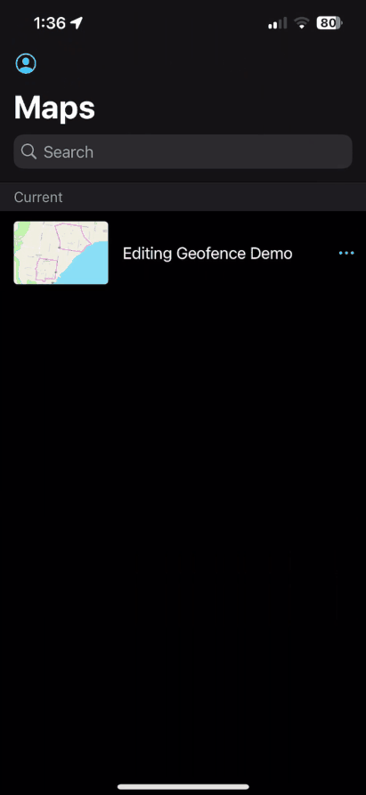

The next step is to test the behaviour in the ArcGIS Field Maps mobile app. In the GIF below, we drop a point outside the boundary polygon features and the form logic prevents our required fields from being edited, which prevents the point feature from being submitted. Once we correct the point location to intersect a boundary feature, the required fields become editable and the new point can be submitted successfully:
