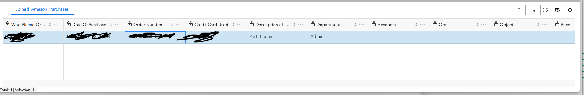

Hello I have an experience builder app that I am working on that is supposed to track some purchases. I am using a join layer as a data source for the table widget that is being populated through a Survey123 form. Initially the value will display but once you try to interact with them they will disappear like the screenshot I have provided. I have all the options turned on for all editors to see all the data. I went into Survey Connect and made sure all the field lengths match the service. I did notice that when Survey created my price field it created a double field type but it does not have a field length. Could that cause this issue? Is there something that I am missing?
I ran into a similar issue today where I had configured a "_form" view layer in a web map and then used it in an Experience Builder app. The table would load fine when logged in on my Admin account, but another user in my org who has an editor role was not able to see these data. I changed the layer source in the map to be the actual feature service and it started working as intended. Not sure if the view issue may be coming into play for you here...
