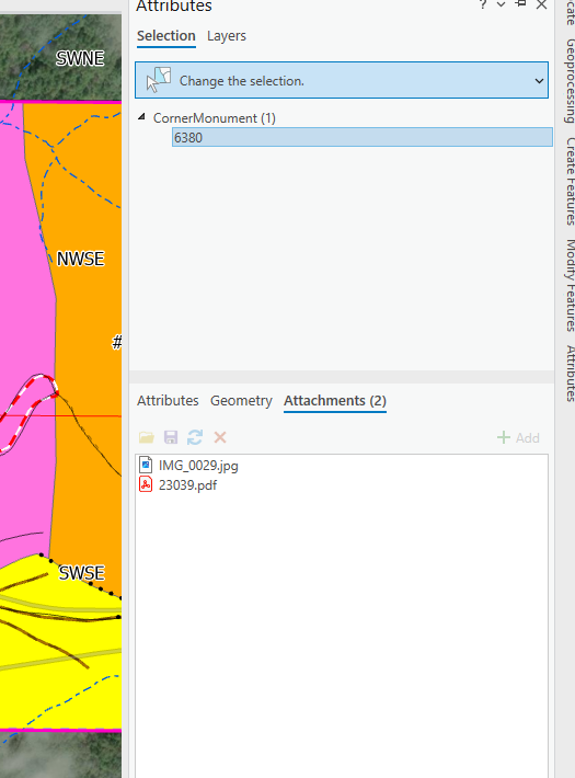

Currentently one of my users above has Add Attachments Greyed out on his Machine but on my computer I could add it just fine on my account and his. Another user sharing the same account could do the same. Any ideas why one user would have greyed out but not the others? (The attachments in the file had to be added by another user.)

The thing is it is enabled for attachments. I have also checked two other accounts, and it works fine for a user who doesn't own the data. Also, the same account on a different computer, and it still works. It is only this computer having trouble.

Correct. I also turned the Editing Session off and on, and still no way to press add for attachments.
