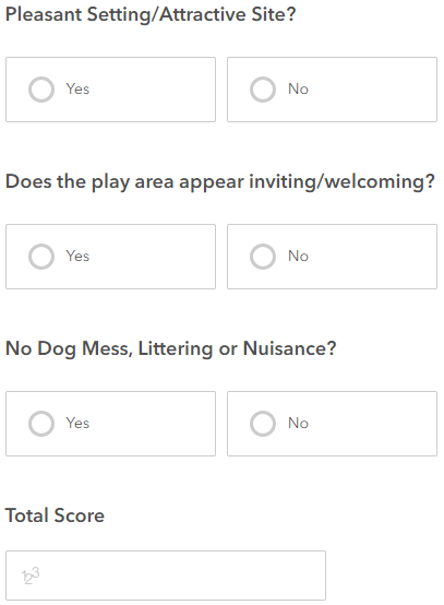

Hello,
is it possible in ArcGIS Survey123 web designer to create a calculation based on Yes and No values entered in something like a Single select type question. The Yes values would have a value of 1 and No values 0. I would like to add these up and perform a total score. Below is a mock up which hopefully helps.
Thankyou
