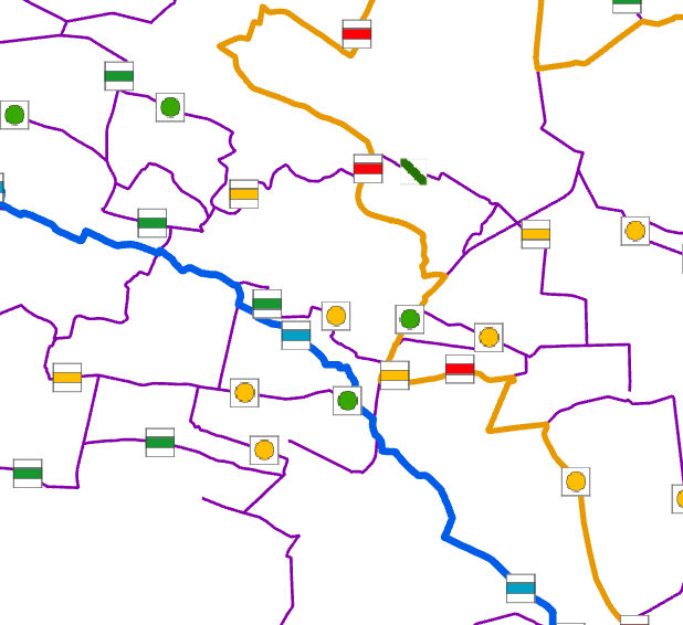

I would like to display tourist routes with their specific symbols. In the desktop area (arcgis pro) I solved this with a background label based on TTF or graphic symbols. This still works when publishing in arcgis server. But in arcgis online the previous publishing fails??
You can publish this as a web style or through your map/layer with the option "use compatible symbols for all apps" unchecked when in ArcGIS Pro sharing panel. The ArcGIS Server label case works if you are using map image layers which are included in the export image the service sends to the client. Feature layers do render the same way and wont achieve the same labeling support.
https://www.esri.com/arcgis-blog/products/arcgis-online/mapping/use-published-2d-symbols-in-arcgis-online/
https://www.esri.com/arcgis-blog/products/arcgis-online/mapping/symbol-styler-using-complex-symbols-in-map-viewer/
Hi Russ, thanks for the reply. I only had time to test your solution today. I had no problems publishing as a web style. My own style also shows up. However, the MapViewer freezes when I open it. I tested 2 versions of the style: Markerlinehttps://lkspn.maps.arcgis.com/home/item.html?id=74a73b0f8f8e410d95b4df999914d226
and labeling a line with a dot symbol, which was previously used in the desktop area (see road labeling)https://lkspn.maps.arcgis.com/home/item.html?id=0772bcb6275d45d5968ca19c5ffe27cfWhat am I doing wrong?Greetings Stefan
Can you share the desktop style file for this one and I can take a look.
Please, here:
red_white_red_bar_line
https://lkspn.maps.arcgis.com/home/item.html?id=418a0617b8b74b479ffe39f98167b1a3
red_white_red_bar_txt
https://lkspn.maps.arcgis.com/home/item.html?id=f4a30355a28342149d1ce9fc5c1a61f5
Thank you!
Thanks! One other question - What kind of placement do you want for these markers? At the end of the lines or positioned/repeating along the line ?
