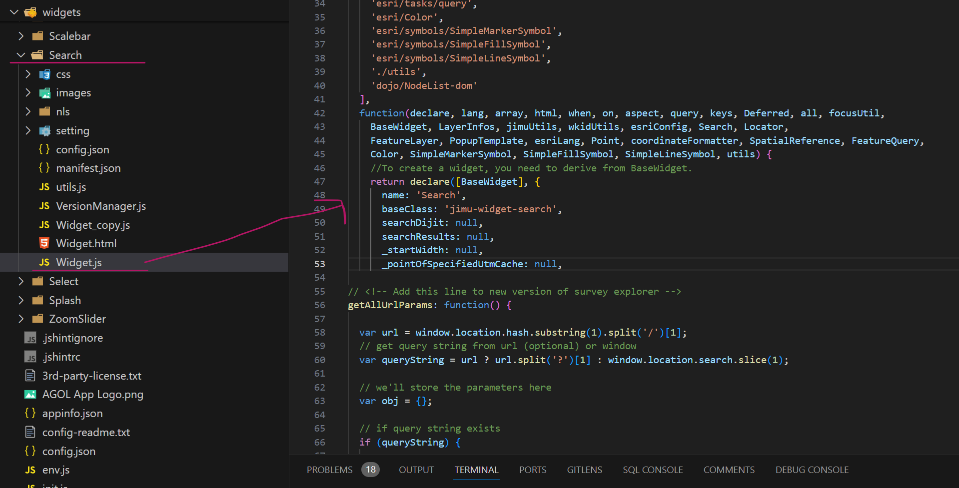

I have WAB 2.25 Dev. Edition and some custom code added to the Search Widget 'widget.js' file. I recently downloaded and installed EB Dev. Edition 1.15. I've been looking for the equivalent code/folder but can't find it. I feel like I've looked everywhere. Hoping that someone can point me in the right direction. Thanks in advance!

You'll need to copy the search widget into the your-extensions folder and modify that version. Modifying the version in the dist folder will not work properly. Follow the link for more details.

It's much more complex in Experience Builder. I believe this is the one you're looking for (in \client\dist\widgets\common\search\src\runtime)
