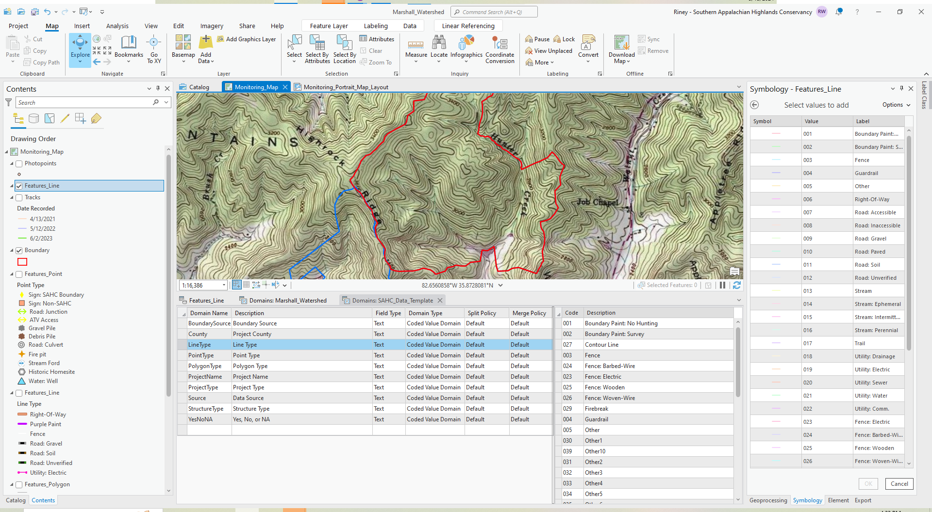

I am trying to sort a list of possible unique values to add to my symbology. The list of values is associated with a domain and is sorted by value. I would like them sorted alphabetically. The list I would like to sort is on the right and the domain associated is to the left of it. Thank you for any help.

I tried that tool and that was able to sort the domain values themselves (seen on the bottom right) but it does not sort the list of available symbology values to add associated with said domain.
In the Symbology Pane, you can right-click on the Label column and select Ascending or Descending to sort the symbology values/labels. Is this what you're trying to accomplish?
Not quite, it is when I'm adding unlisted values. I would like to sort the list of unlisted values. I AM able to sort the list of values under the classes tab in the symbology pane. However, this is not what I'm trying to accomplish. For my workflow, I set the Primary symbology to Unique values and for my field I use an organization wide domain. I only need certain values from that domain so I remove all values, which then sets them as unlisted. I then pick out the unlisted values I need. Having that list of domain values (now unlisted) sorted by ascending name would be helpful. I am also using version 3.1.3 which I know is not the latest version.
