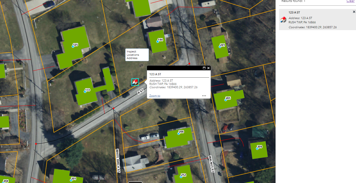

Here is a picture of the WAB Reverse Geocoder - It shows the calculated address at the point where you click on the map.

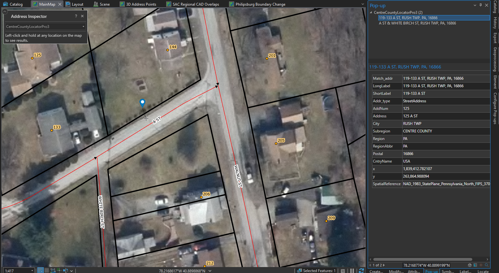

Here is a picture of the reverse geocoder in ArcGIS Pro - Notice the Match Address vs the Address field that is output from the Address Locator.

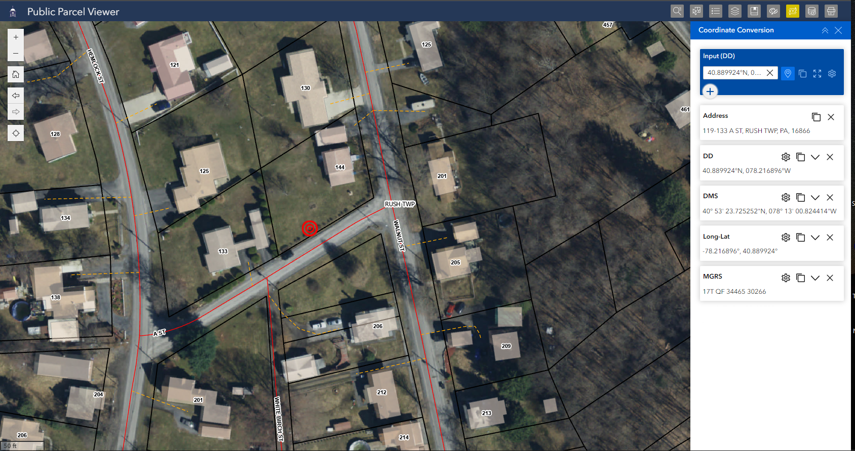

Here is a picture of what the EXB Reverse Geocoder outputs - Notice on the right side under address it gives the Match Address and not the actual address.
So, my idea or enhancement here is that there needs to be a configuration here to allow this tool to use the address field. If a configuration is not possible then this tool needs to be changed to read the Address field rather than the Match Address.
