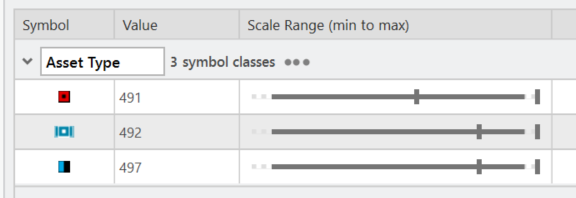

Unfortunately, symbology scale dependencies will dynamically hide layers from the contents pane when layers are outside of the set display range (see example below).
As each subtype (asset group) almost always represents several asset types, and as these asset types often represent features in different voltage levels (high / medium / low) standard symbology setting is used to set different scales for the different asset types.
MV represents medium voltage asset types and LV represents low voltage asset types in the above example.
Hence, the map shows e.g. medium voltage at scales up to 1:50.000, whereas low voltage typically is not added before zoomed in beneath 1:3.000.
