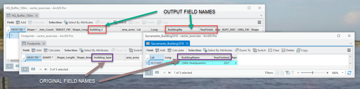

My work unit recently upgraded from ArcGIS Pro 3.1.2 to ArcGIS Pro 3.1.3 and while updating training material created using ArcGIS Pro 3.1.2 I noticed that my field names are truncated in the outputs of geoprocessing tools. I ran a spatial join and the results truncated the output FC (not exporting to SHP) field names to 10 characters. This did not occur in AGP 3.1.2. Has anyone encountered this? Is there a solution rather than a work around? I do not want to alias the fields to get my original field name. Here is a screen shot of the two input tables of the spatial join and the output table:

I have ran it a few times and have gotten inconsistent results - I re-ran and it worked as expected, I am going to test a few times because I need to know what will happen when I run trainees through an exercise next week
I was exporting to a non-project GDB and selected the GDB in the file chooser and typed my file name rather than clicking into the GDB so the file was exported as a shapefile - no problem here
