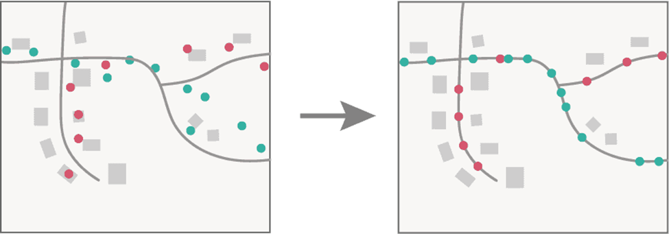

Snap Tracks is a tool in ArcGIS GeoAnalytics Engine that allows you to “snap” input track points to line segments. For instance, you can take time-enabled GPS points and shift them so that they align with the road segment(s) that they follow. This is a great way to clean up messy input point data and create coherent network paths.

The result is that our original GPS points (red) are “snapped” over to align with the road segment (grey), as seen in the image on the right. (Blue lines have been drawn between the original point and the snapped point for reference.)
Nodes snapped to road centerlines
