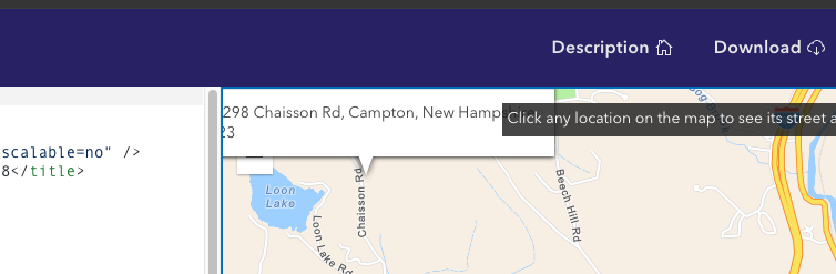

I am experiencing an issue where on the first click after a page load, (with default settings) the popup always opens above the click location, causing it to overflow the div and end up out of view. Every click after first seems to reliably work and doesn't collide with the edge of the map. Is this a known issue or am I missing a way to avoid this without docking the popup or something? I am able to reproduce this problem in the sample code snippets. https://developers.arcgis.com/javascript/latest/sample-code/intro-popup/See below:first click after page load

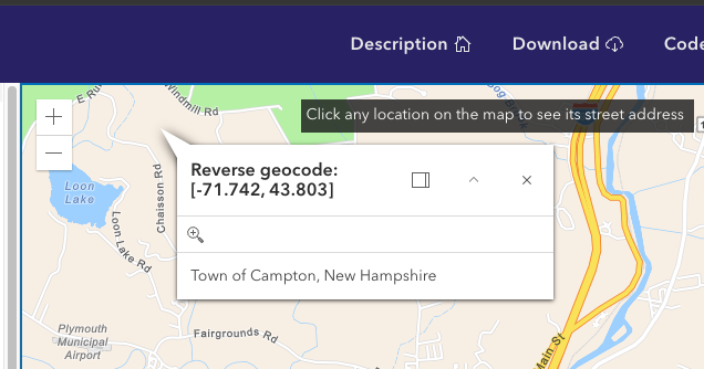

second click (and beyond) after page load
