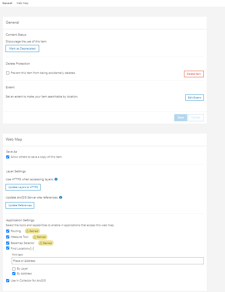

I has created Maps using offline, but i can't download maps offline on mobile device
error image:
