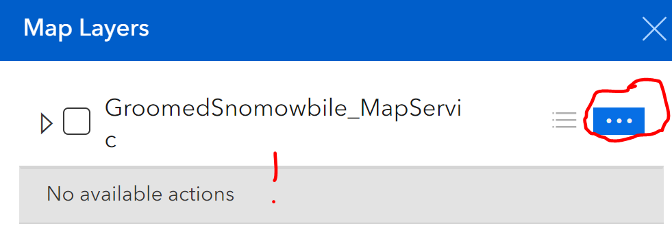

- NEED A REMOVE MENU ITEM (once the Remove function works...) next to the added layer in Layers list. (Is this a Layer Widget setup item I have missed?) [It's just in a different place than expected, see lower-right corner of screen. Would be nice if in here though...]

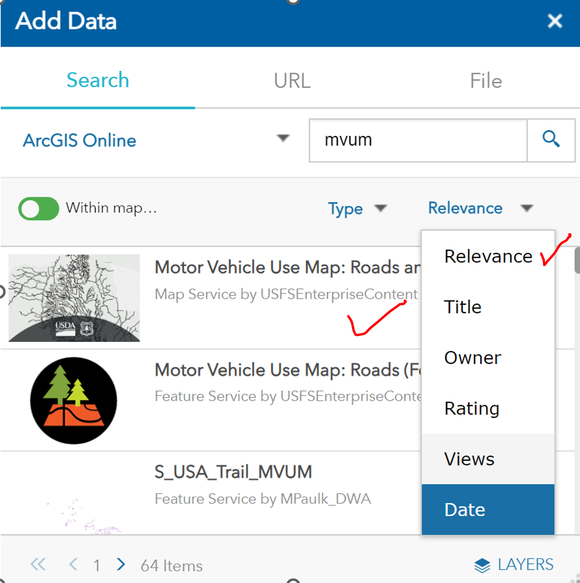

- Order of keyword search results does not seem to have the good relevance WebAppBuilder results had. How might this be improved? [There is no Relevance-etc. pulldown as was in WAB.]

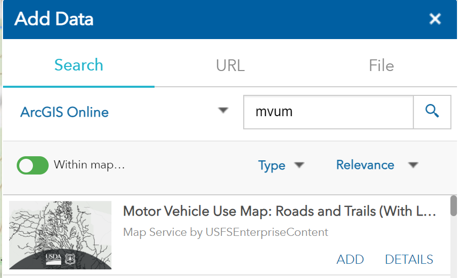

Example: in a Web App, try search on "mvum" top one and most appropriate will be this:
Same exact search in EB version result in a slew of non-authoritative results and the good one that comes up first in WAB version is instead ~70 results down the list. Are results popularity-driven and won't improve until enough users make the same choice in plurality, ala a Google search?
Or maybe it's just that Search by keyword needs an additional result filters like Relevance, not just Layer type. Relevance seems to work very well in WAB as the default result order...

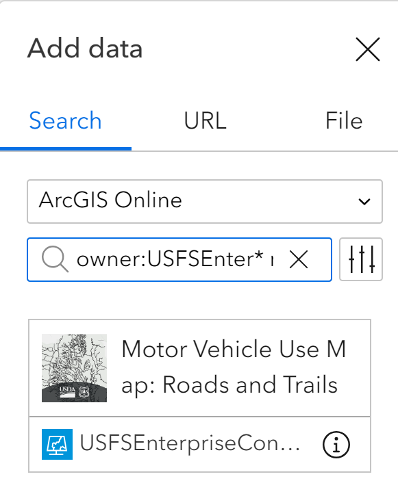

Yes, adding owner:... makes for a great result set, but Joe Average web map user does not know the search tricks, like...
[owner:USFSEnter* mvum]
