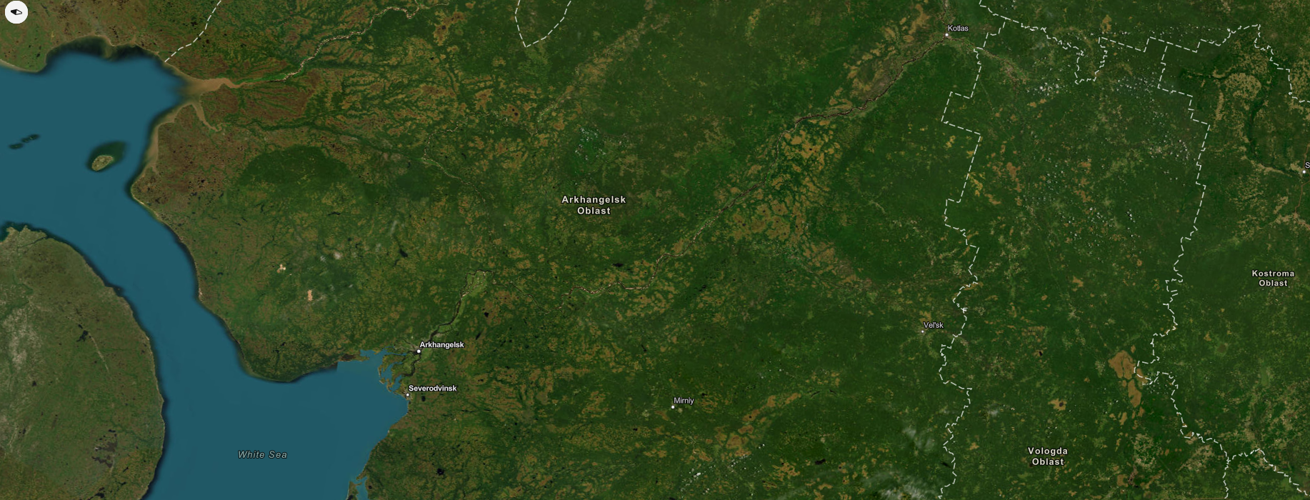

Hello I have an issue with a compass widget, the issue is that even though I rotate the map and the click on the compass it doesn't rotate back so that north is up. This is my code:(my typescript):
I click on the compass but nothing happens, any idea why?
