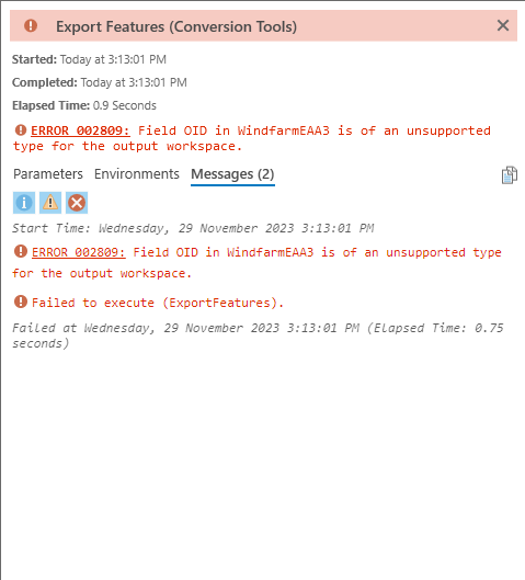

I am using ArcGIS Pro 3.2 and have come across the Error 002809: FIeld OID in xyz is of an unsupported type for the output workspace. I have not been able to find this error in ESRI resources or community chat. It seems like an obvious problem that should not exist given the limited options for export from the geodatabase in Catalog. The geodatabase requires the OID and fails to export as FID or appropriate for shapefile. Any ideas gratefully appreciated.
Work around, use Geoprocessing Feature Class to Shapefile tool, right clicking and selecting Export to Shapefile in the Catalog is fraught.
