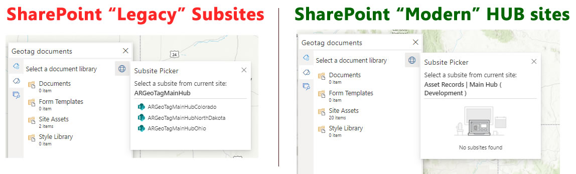

I'm a SP Admin/Dev and installed the ArcGIS SharePoint Webpart in our MS Tenant.Did a quick POC where I was able to display SharePoint GeoTagged documents across multiple SharePoint SUBSITES with ease. Geotags wrote to the SharePoint Term Store perfectly, etc...
The problem is that I have architected project with the more modern SharePoint HUB sites.Are there any plans to implement HUB Site picker in the webpart when geotagging SharePoint Document Libraries ? I acknowledge the complexity of traversing 3 or 4 hub levels to aggregate doc libraries.https://learn.microsoft.com/en-us/sharepoint/planning-hub-siteshttps://sharepointmaven.com/hub-sites-vs-subsites/

@BrianLabelleSMLP - Thanks for reaching out to us. I really appreciate your question. Currently we do not support "Hub sites" for the geotagging workflow. But I am going to add this to our backlog, discuss this with the leads and provide you an ETA as to when we can have this enhancement available to our users. I will keep you posted.
