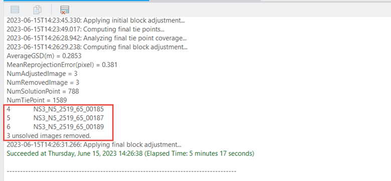

While working with OrthoMapping and Scanned Aerial Imagery, I found error "Unsolved Image Removed" during the block adjustment process. I was wondering if you could help me understand.
Thanks,Jake

Good day. If the above is still an issue I would love to look into possible causes and solution. It appears you were working with just six images. Is that correct? If yes could you share the images, frames and cameras information used to create the workspace?

Hi @Jake ESRI experts will have the full answer, but in my experience it would mean that you do not have sufficient, accurate enough or zero tie-points in these images. Hence they are not included in the aerial triangulation.
