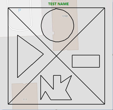

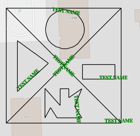

Currently LabelClass property repeatLabel has two options: true, flase. Where:
If false, the label will display once per polyline segment.
We use polyline feature layers to display very complex polyline geometries with more than one segments, similar to svg symbols. But unfortunatly there is no option to display lables for such features in readable userfriendly way.
Here is an example:
The ideal option would be the ability to display label once per whole polyline, not per segment.
So the main idea here is to extand repeatLabel property with possibility to define exact number of repeats or just a limit "one per polyline".
You can find repropduction of this geometry here: https://stackblitz.com/edit/js-lwwmfb?file=index.html or in a code below.
