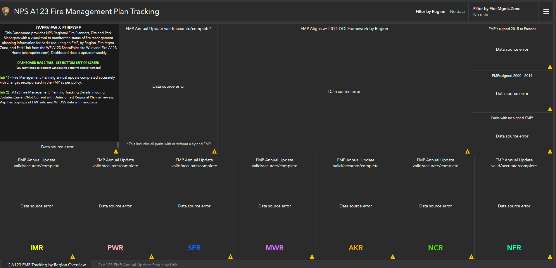

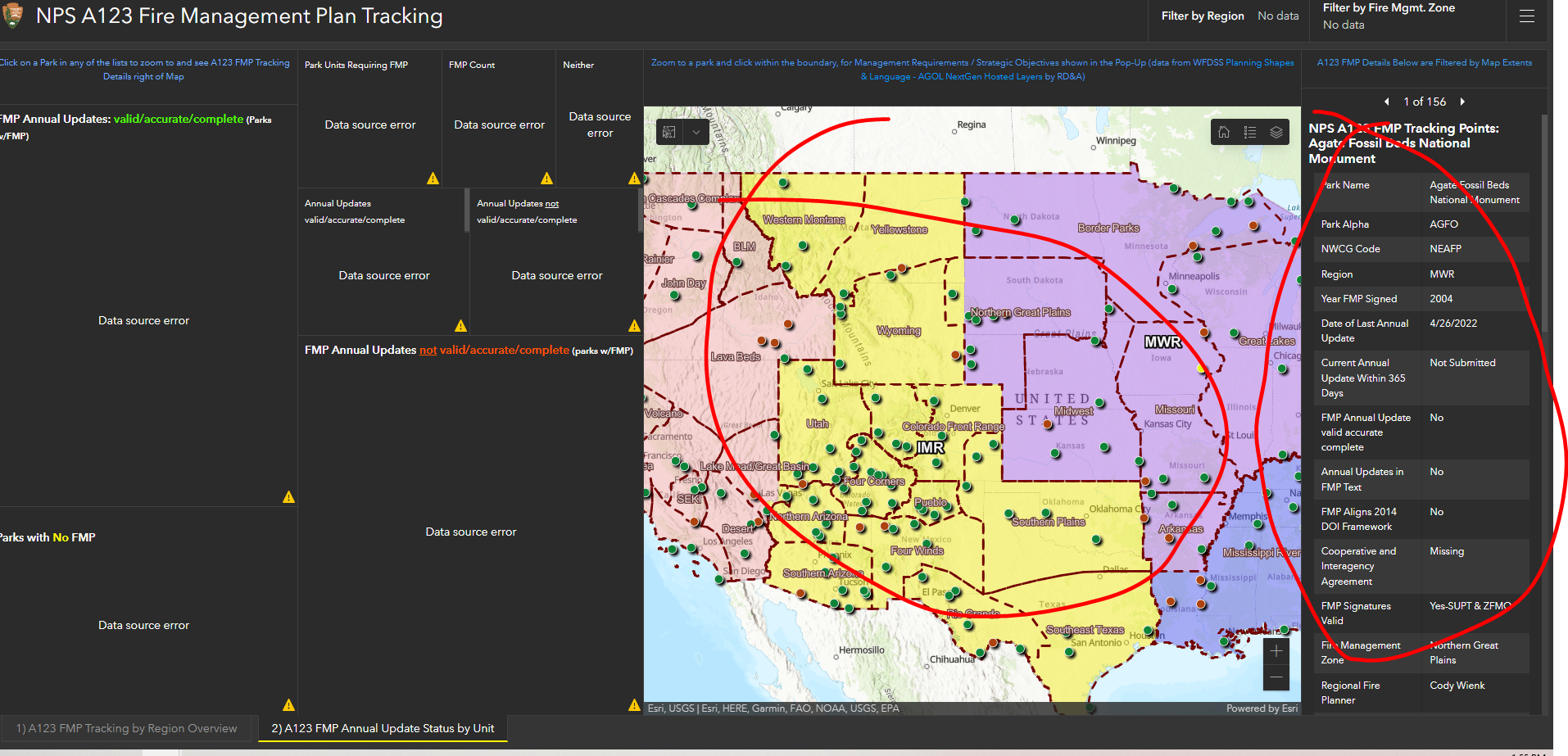

I just opened a dashboard that uses a single hosted layer and all widgets are broken with a "Data source error"! Its shared only within the NIFC ArcGIS Online Organization. This happened a few years ago due to an issue with filtering by date. No idea if its the same issue. The data loads in the map and feature details without issue. Can someone from ESRI please reach out?

@jcarlson Yep - allowed to edit dashboard (org sharing only on D-board - same as hosted layer). Data is a hosted layer with 307 records (only) that I update weekly through the item page using append with a common attribute field and an csv to update the attribute table. Geometry doesn't get updated (points). Been following that process for months w/o issue. When I go to settings for any widget now, it takes me to select layer dialog. The layer shows there, it loads in the map just fine and like I said the feature details, the data loads no problem. Do you know when ESRI completed an update that affected Dashboards? - Thanks!

Thanks again for you replies! Yeah I can create new widget no problem. I'm pretty sure I could spend the time (begrudgingly) and repair ALL the widgets and LOADS of actions, but honestly, I think it may be time to move on and bin this. I find it pretty ridiculous. This happened a few years ago apparently caused by using the time/day filter "in the last xyz number of days", but ESRI fixed that (it wasn't and still isnt shared publicly). This time however even widgets that have NO filter are broken as well. Tried clearing the cache and that didn't help.

@MartinCopping Hi Martin - thanks for your reply. A little confused by your post as you noted there is a bug, but then suggest the layer could have been re-published or overwritten? Sounds like it may happen inadvertently on the server side? I use the data in other apps (EB) and no data breaks there. It also seems curious that the feature details widget (and the map widget) didn't lose connection but all the lists, gauges, indicators did. I just went ahead and fixed the widgets and actions. Didn't think to look at AGO assistant. Just a little concerned as I mentioned to Josh, above, that when I'm through with my role at NPS, that if it happens again, someone else's 'fix' would be with the delete button, most likely. Sincerely appreciate your post reply.
