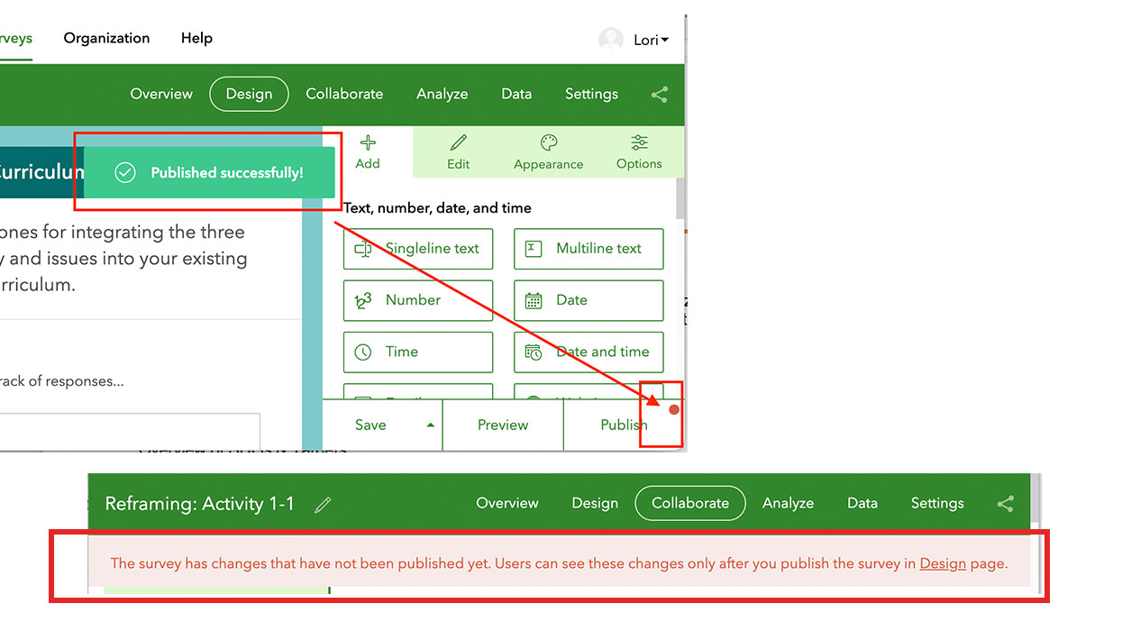

Survey123 (v3.17) is not showing completed publish command.
Publish a survey & "Published successfully!" message appears, but the red dot still visible on the Publish tab.
Go to Collaborate to share survey and this error message is at top of page: "The survey has changes that have not been published yet. Users can see these changes only after you publish the survey in Design page."
See screenshots below:
I have the same issue - has this bug been resolved?
A friend of mine is working through this issue with ESRI Technical Support.
Here are the details of the bug for your reference:
Bug Number: BUG-000154641Synopsis: The ArcGIS Survey123 web app does not recognize when changes are saved and published after modifying a survey with a multiple-choice question.Status: Under Consideration
Bug Number: BUG-000154545Synopsis: Notification that "survey has changes that have not been published yet" appears despite the fact that survey was not edited if Map question is included in Survey123 ArcGIS Online webStatus: In Product Plan
Same here. The survey (v 3.17) publishes successfully but the next time I log into Survey123 I get "The survey has changes that have not been published yet..." warning. It happens even if I clear my web browser's cache. Is there a way we can look up the bugs @ZacharySutherby lists above?
I have the exact same issue. I know it's saved and published, and it's working fine...but that message keeps showing up.
Hello @LoriDelacruzLewis,
I would suggest reaching out to Esri Technical Support to take a closer look, you may be running into BUG-000154545 or BUG-000154641.
