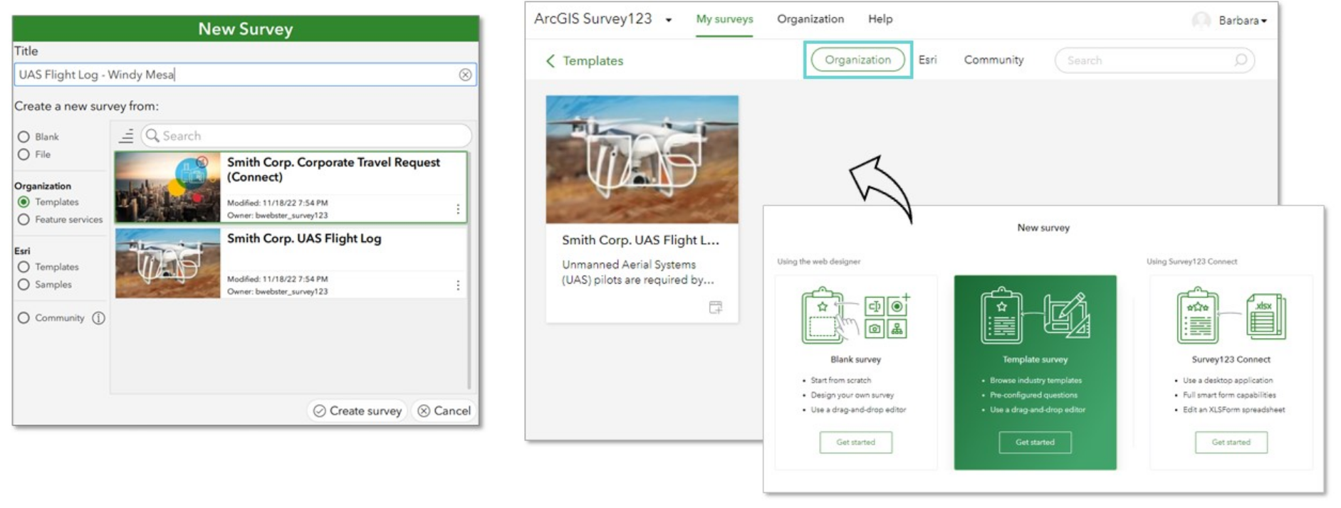

One of the new features included in the ArcGIS Survey123 October 2022 release (3.16) is the Organization templates setting. This option allows an organization administrator to share template surveys with other form authors in the organization. These templates appear in the New Survey dialog in Survey123 Connect or the Survey123 web designer.
Many organizations create the same kind of survey repeatedly, so using an organization template allows the survey author to quickly find and create the new survey and then make any further customizations that are needed.
Templates can also be used to model best practices in survey creation. Just as the Esri samples section demonstrate the capabilities and best practices for using various Survey123 features like appearances and calculations, there may be industry-specific best practices that can be modelled in a template for the organization’s survey authors. Organization templates are also an excellent way to standardize the design of surveys. This can include the look and feel of surveys, incorporating corporate branding, or standardizing data elements like choice lists or hidden metadata questions.

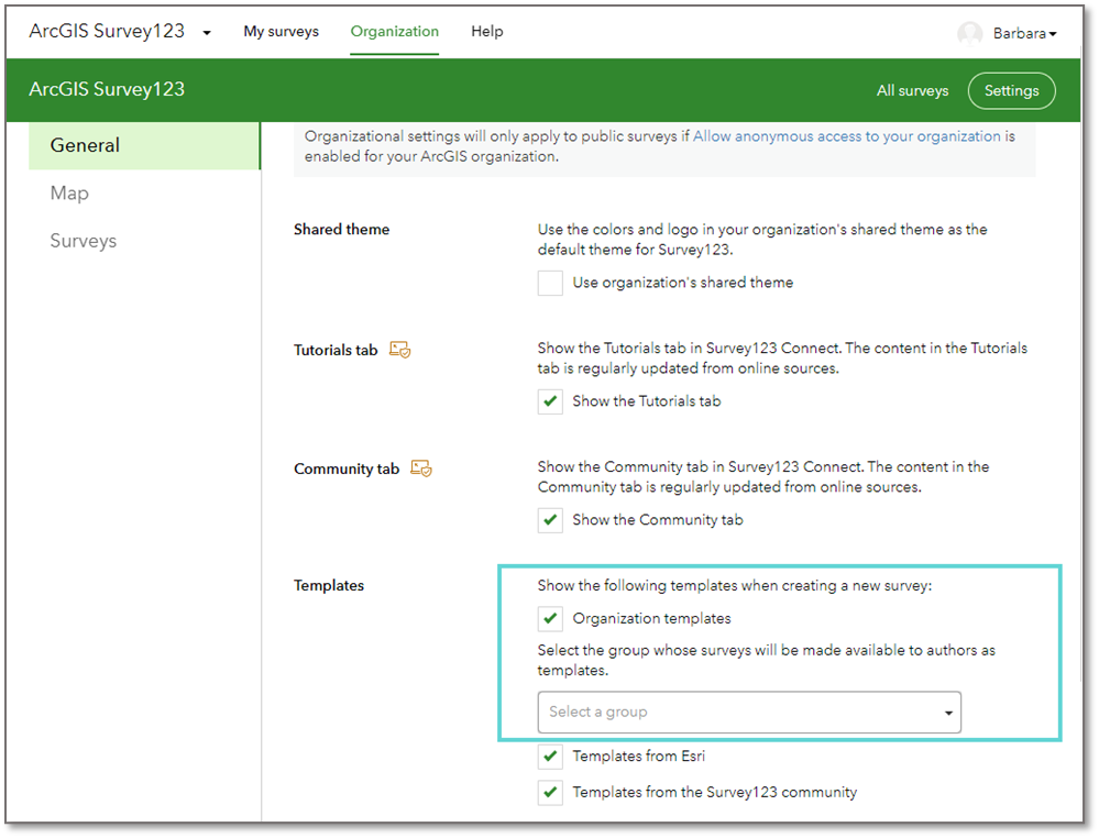

The organization administrator enables organization templates with the following steps:
- Create a group that will contain the templates.
- In the organization settings in the Survey123 website, enable organization templates and select the template group.
- Populate the template group with surveys.

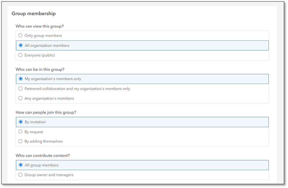

Group settings
There are no specific group setting requirements for an organization template group , but administrators should take into consideration how group settings will affect their organization templates. See below for discussion on how specific group settings affect organization templates.
- Who can view this group
- Only group members – Organization templates will only be available to members of the organization template group. This option may make sense if the administrator only wants a subset of organization members to have access to the organization templates.
All organization members – Organization templates will be accessible to all members of the organization, although it will still be possible to restrict access to individual templates, which is discussed in the next section. This is a good option if the organization administrator wants the entire organization to have access to the group and doesn’t want to have to add organization members to the group.
Everyone (public) – The template group will be publicly accessible. Organization members would still be able to see the contents of this group in Survey123 Connect or the web designer, but members of the public would also be able to see the group by searching in ArcGIS Online.
Who can be in this group – Organization templates are configured at the organization level and it’s not possible to use a group from another organization as a template group, so it makes the most sense to select the My organization’s members only option.
How can people join this group – This setting depends on how the organization administrator prefers to manage the templates group. If the group is set so only group members can view the group, the organization administrator will most likely want to maintain control over new members joining the group and will choose By invitation.
Who can contribute content – Similar to the last setting, this will depend on the preferences of the organization. Many organization administrators will want to control which surveys are added as organization templates, so will choose Group owner and managers.
Enable organization templates and select the template group
The options to enable organization templates and select the template group are in the Settings section of the Organization tab of the Survey123 website. Only users that are organization administrators will be able to see the Organization tab.
In Survey123 Connect, these organization settings are updated on sign in, so any changes to these settings will be seen either after restarting Survey123 Connect or after signing out and back in again. In the Survey123 website, changes to organization settings will be seen when the browser is refreshed.
