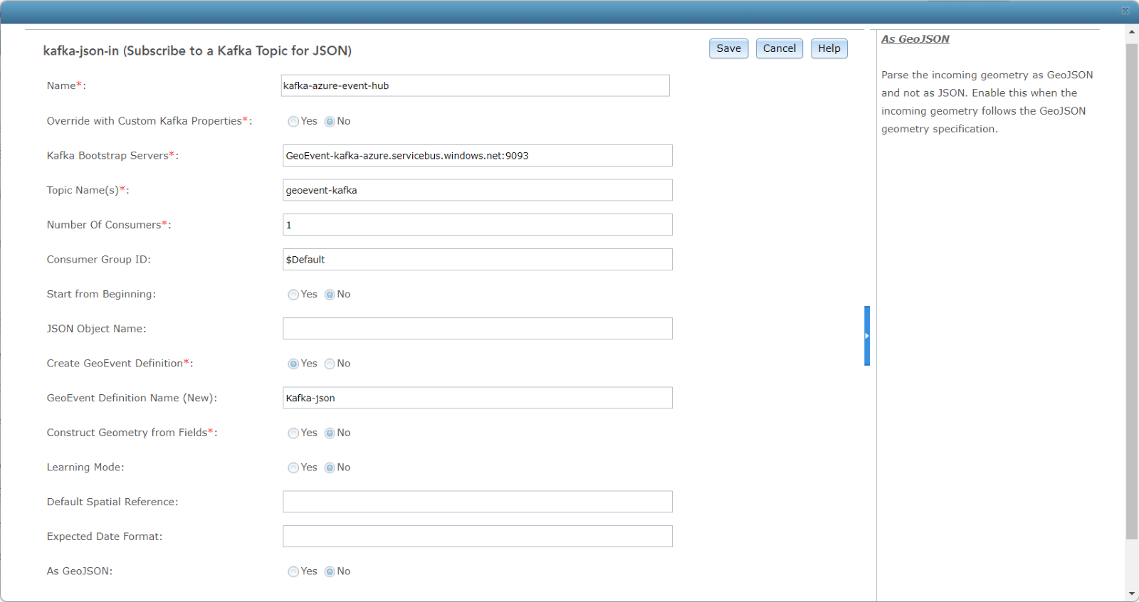

The Subscribe to a Kafka Topic for JSON input can be configured as the example shown in Figure 16 below. In the Kafka Bootstrap Servers field, fill in the hostname of your Azure Event Hubs namespace and specify the port to be 9093. One thing to note is that this port needs to be open on the firewall for Kafka to communicate with Azure Event Hubs. The Topic Name should be the name of your event hub instance. You can choose to create a new GeoEvent definition based on the incoming data or select an existing GeoEvent definition that matches the schema of the incoming data.
Figure 16. The configuration panel of the Subscribe to a Kafka Topic for JSON input

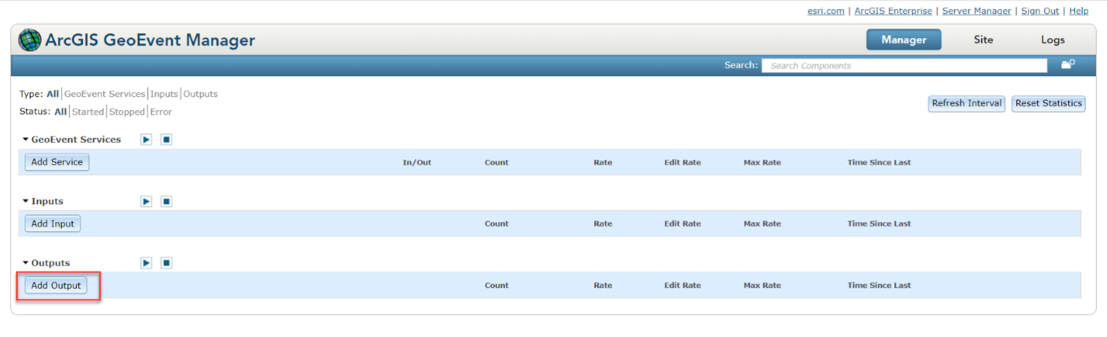

To configure a GeoEvent output to send data to Azure Event Hub, navigate to Manager tab and click on Add Output.
Figure 18. Click on Add Output on GeoEvent Manager

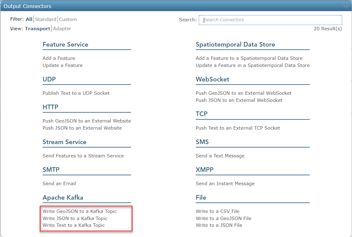

The output types that can write data to Azure Event Hubs can be found under the category Apache Kafka. In this blog, we will configure a Write JSON to a Kafka Topic output as an example.
Figure 19. List of available output types on GeoEvent to work with Azure Event Hubs

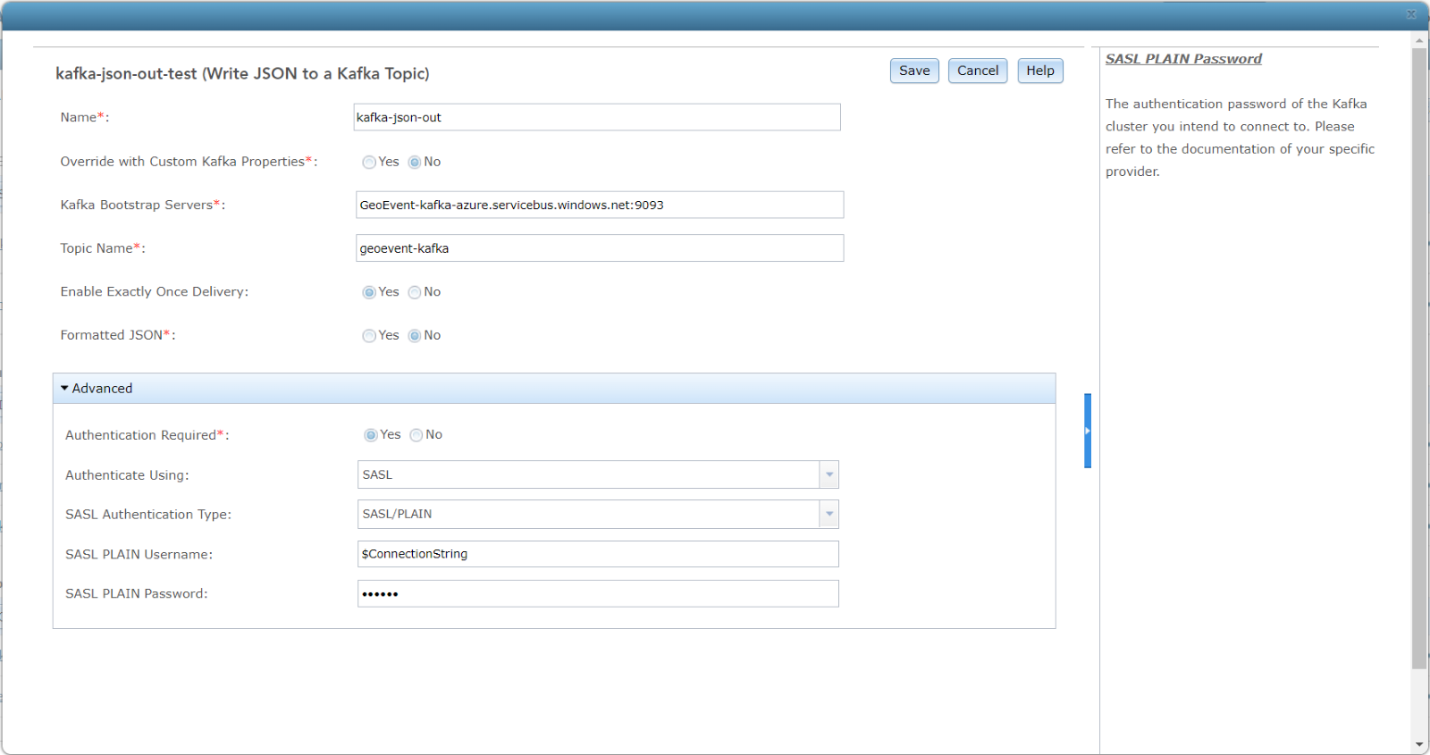

The Write JSON to a Kafka Topic output can be configured as the example shown in Figure 20 below. In the Kafka Bootstrap Servers field, fill in the hostname of your Azure Event Hubs namespace and specify the port to be 9093. One thing to note is that this port needs to be open on the firewall for Kafka to communicate with Azure Event Hubs. The Topic Name should be the name of your event hub instance.
In the Advanced section, the value of the SASL PLAIN Password should be the connection string obtained from the Azure Event Hubs namespace. Finally, click on the Save button to save the configuration. Start the GeoEvent output by clicking on the start button.
Figure 20. The configuration panel of the Write JSON to a Kafka Topic output

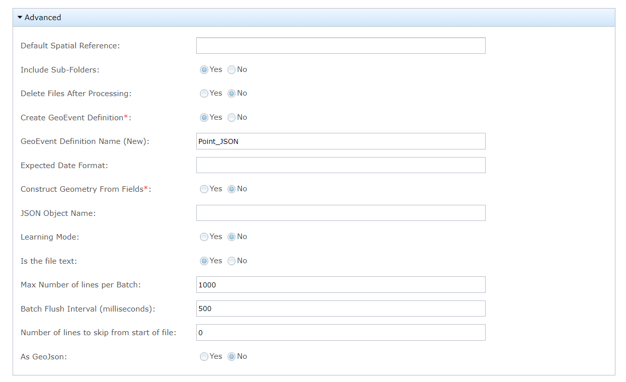

Create a Watch a Folder for New JSON Files input to read the test data. The input should be configured as in Figure 21 and 22 below. The value in the Input Folder DataStore field should be replaced by your own folder that contains the test data as a JSON file.
Figure 21. Configuration of watch a folder for new JSON files input
Figure 22. Configuration of watch a folder for new JSON files input

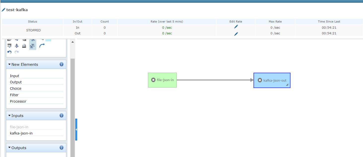

Create a GeoEvent service as shown in Figure 23 to send the JSON data from the Watch a Folder for New JSON Files input to the Write JSON to a Kafka Topic output. Both input and output should be stopped at this point.
Figure 23. Simple GeoEvent service to send the test data to Azure Event Hub

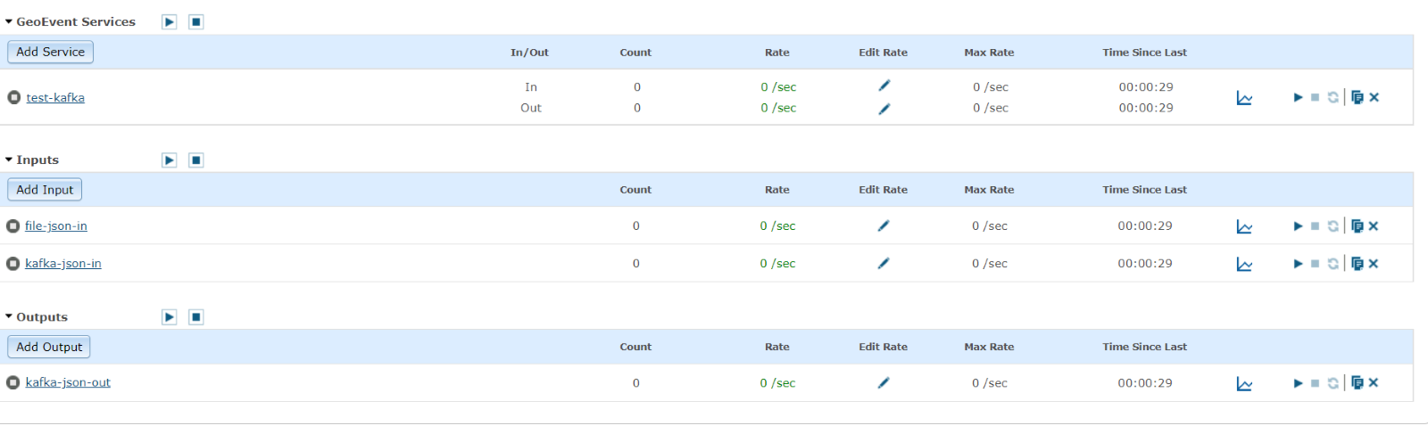

Follow the steps outlined in the previous section to create a Subscribe to a Kafka Topic for JSON input. It should be ingesting data from the Azure event hub the Kafka output is sending data to. After the input has been created, navigate to Manager tab in GeoEvent Manager. As shown in Figure 24 below, there should be a GeoEvent service, one input to read JSON data from file, one input to read JSON data from an Azure event hub, and an output that sends JSON data to the same Azure event hub.
Figure 24. GeoEvent Manager with the necessary elements to test Kafka connectors

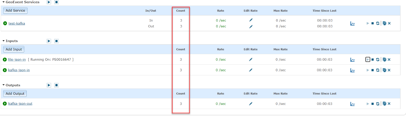

On GeoEvent Manager, first start the Kafka input and output. When they are both running without error, start the GeoEvent service. Finally, start the input that reads JSON data from file. If the Kafka connectors are working correctly, then the counts should be consistent among the Kafka input and output. The amount of the data sent to Azure Event Hub from GeoEvent should match the data ingested by GeoEvent from Azure Event Hub.
Figure 25. GeoEvent Manager after all components have been started
