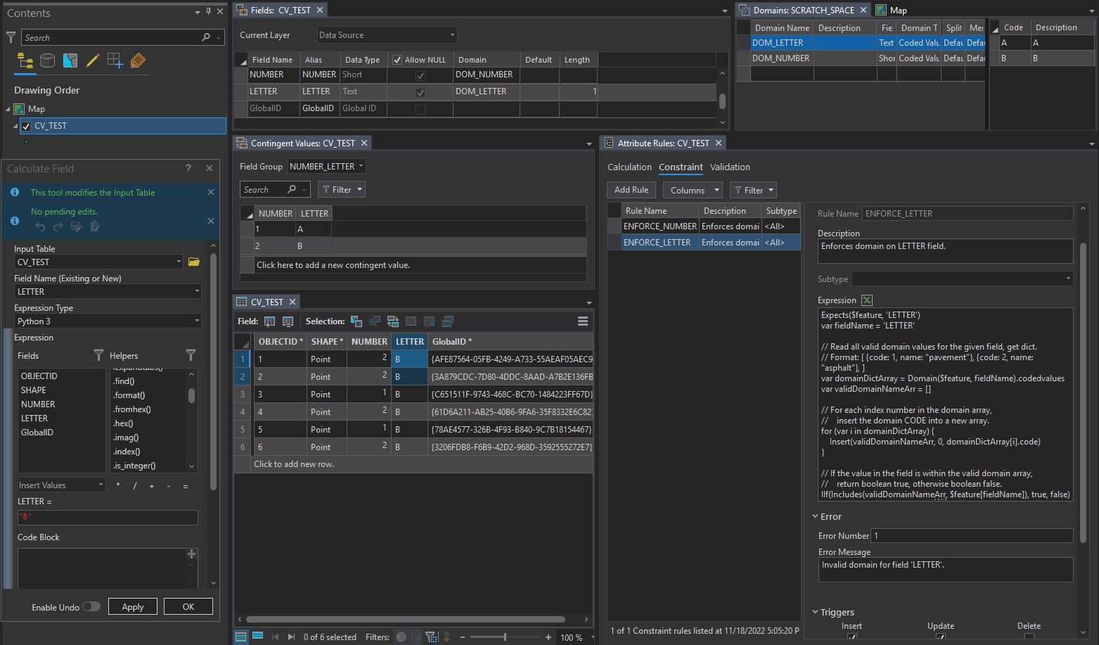

Image below:
- Fields Table showing fields and applied domains
- Domains Table showing the two domains (can only show the codes/descriptions of one domain...)
- CV Table showing the allowable contingent value sets
- Attribute Rule enforcing domains in a field, even with Field Calculator
- Attribute Table, with invalid 1-B sets of values, after the Field Calculation
With Field Calculator, it's possible to achieve invalid CVs, even when the Field Group is "Restrictive."
