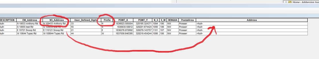

I need some assistance creating a ArcPy script to field calculate and display the value of a field based on the input of another field. I would like to show the value of attribute NS_Address if the Prefix attribute is N or S and I would like to show the value of attribute EW_Address if the Prefix attribute is E or W.
Make the address field active.
put the function in the code block.
the expression in the expression box
and calculate away

my_func(!Prefix!, !NS_Address!, !EW_Address! )
Something like this? Untested code...

Thanks for the reply. I received the error below when attempting to run that calculation.
I just had to add a colon after the first line. The expression ran perfectly! Thank you!!!
