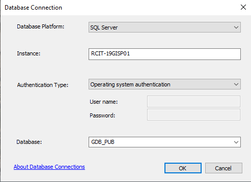

The search tool will verify that your current active map has the layers the tool requires. If necessary it will add them to the map provided that the tool is able to create a Database Connection to the SQL Server Database Platform using the RCIT-19GISP01 Instance with Operating System authentication using the GDB_PUB Database.

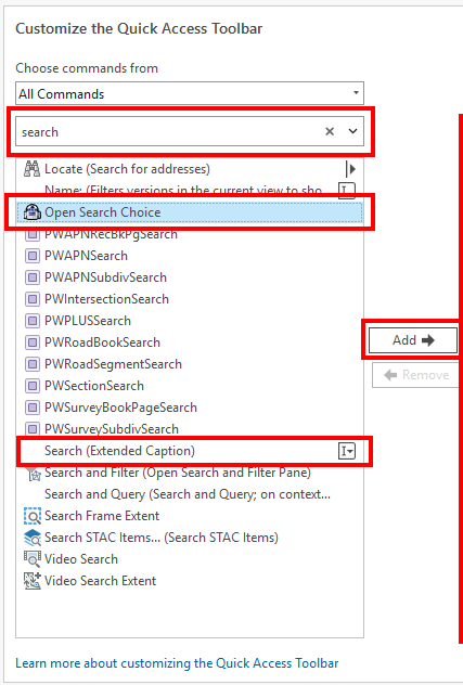

ADDING THE SEARCH TOOL ADD-IN BUTTON AND COMBOBOX TO THE QUICK ACCESS TOOLBAR
For easy access to the tool you can add the Search button and combobox for search options to the Quick Access toolbar as a onetime set up. Do the following:

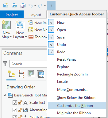

Dropdown the Customize Quick Access Toolbar menu as shown and press the Customize the Ribbon option.

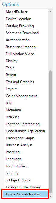

In the Options dialog scroll to the bottom of the list on the left side of the dialog and press the Quick Access Toolbar option.
In the Customize the Ribbon combobox in the Options dialog choose All Commands

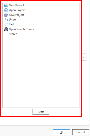

Type search into the textbox dropdown and choose the Open Search Choice button and press the Add button and then choose the Search (Extended Caption) combobox and press the Add button. The icon for the Open Search Choice button has changed from a Cat to R2D2.
The list of tools should look like the items shown below and press the OK button
The Quick Access Toolbar should now look like this.

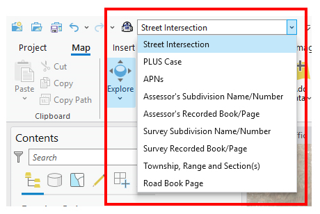

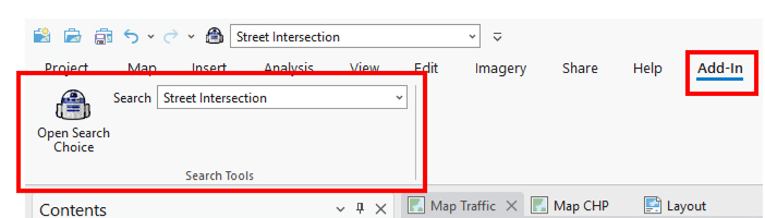

You can also access the Search Tools through the Add-in tab:
Choose the search you want in the dropdown and press the R2D2 button to launch the search dialog.
